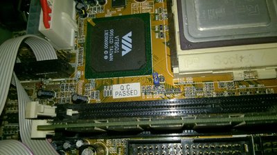

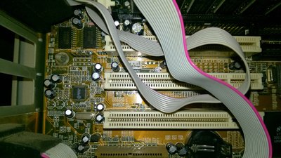

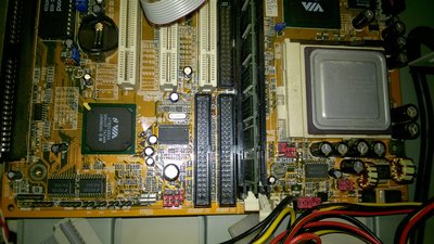

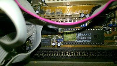

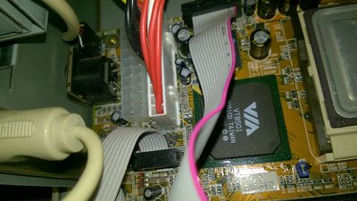

Someone sent me photos of a motherboard that is still inside a pc. It might be bit difficult but if anyone can recognize the brand and model of the motherboard, please let me know.

Reply 2 of 4, by Warlord
Looks like AT board with AT keyboard and a PS2 Header.
Socket 7
No AGP slots but does have a tleast 1 ISA slot from the looks of it
The little brown slot is a AMR slot and, I remember only things that fit in there are win modems, so that slot is not useful.
If you are going to use that the lack of a AGP slot will limit your video card.
Reply 4 of 4, by Baoran
Seems very close. The minor differences might be just different revision of the board. Good to know that it is an MVP4 board. The MVP4 on chip video isn't very good if I remember correctly.
Thank you for the help.
