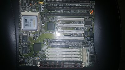

Well, I used the same two old IDE cables. Connected the CDROM to the IDE1 as master and the CF card to IDE0 as master... and it found the CDROM.
But with both on IDE0 with the CDROM as slave... no joy.
I connected the CDROM to IDE0 as master... found the drive.
This makes me think my old K6-2 board isn't broken.
I dug the old motherboard... pretty sure it's a super socket 7.

Super Socket 7 motherboard?
I saw the two power inputs there by the keyboard socket... does that mean this motherboard could take an ATX power supply?

Looks like a 20-pin ATX power input, modern PSUs have 24-pins but may have the last 4-pins separately or you can use an adapter.
The common denominator looks like the hard drive from what you say but I'd probably give it a bit more testing than just BIOS detection appearing once.

that is indeed a cross compatible AT/ATX board. You might have to configure it or it might just be plug and play. Always a good idea to find the manual for your board if possible so you have a clue of what you're doing and what the choices are.
