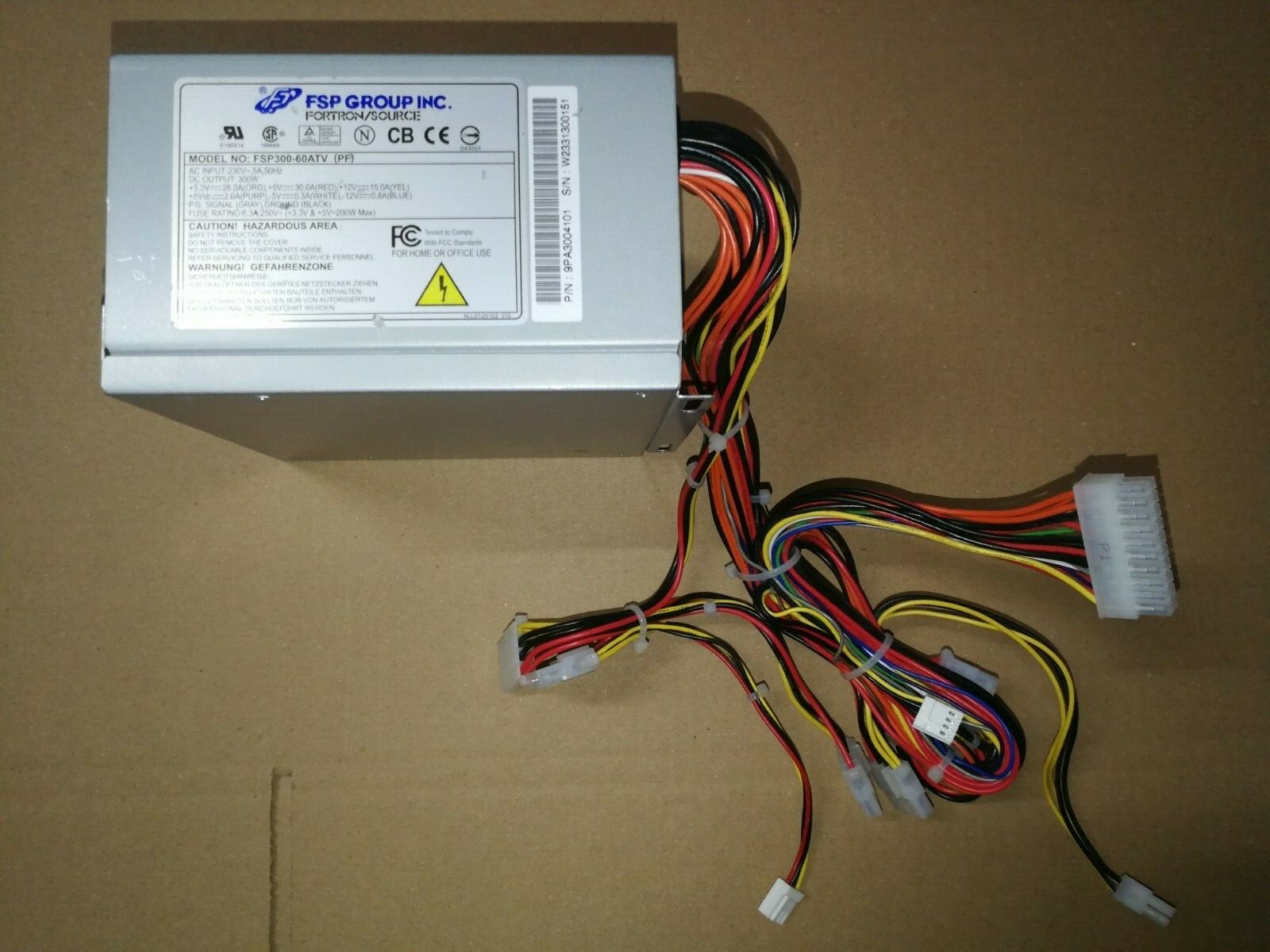

Kmex pz-400 (https://i.ebayimg.com/images/g/pqcAAOSwoYlc4hFM/s-l1600.jpg) 400W: 3.3v: 26A, 5v: 46A (Combined power max: 225W) +12v: 20a.
Chieftec atx-1136h (https://i.ebayimg.com/images/g/lkYAAOSwjLJc43I5/s-l1600.jpg) 360W: 3.3v: 26A, 5v: 35A (Combined power max: 230W) +12v: 18a.
Xxpower lc-b400 (https://i.ebayimg.com/images/g/wjUAAOSwUr9c43Up/s-l1600.jpg) 400W: 3.3v 28A, 5v: 30A (Combined power max: 225W) +12v: 20a.
FSP Fortron/Source fsp300-60atv (https://i.ebayimg.com/images/g/GDMAAOSwf0dcng7x/s-l1600.jpg) 300W: 3.3v 28A, 5v: 30A (Combined power max: 200W) +12v: 15a.

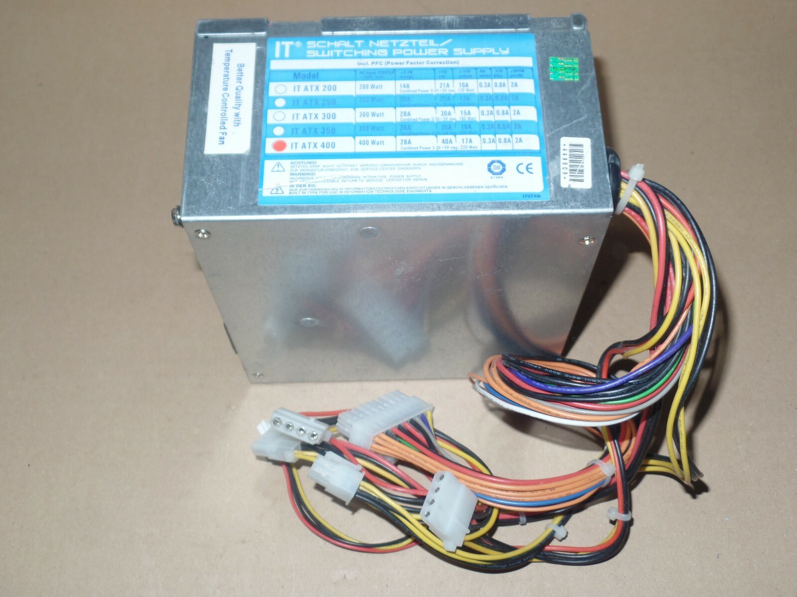

IT ATX 400 it07xb (https://i.ebayimg.com/images/g/tSUAAOSwOSVdFkZx/s-l1600.jpg) 400W: 3.3v 28A, 5v: 30A (Combined power max: 200W) +12v: 15a.
In the end, what should I buy in your opinion?

seasonic and the FSP are the only brands in your list id personally let touch any of my computers. They are both okish brands, nothing great but good enough if they are good model numbers. zippy/emacs is a good power supply for retro computers if you can find the right one for good price. that part is hard.

Thank you for the feedback, don't you trust Enermax? I think that the fsp 300 watt could be not enough...

The Chieftec is an Enhance build which is an OEM on par with FSP.
I have an Enermax EG475P-VE that looks similar to the one you posted and it's built like a tank. I recapped mine since it used dubious capacitors and it's from around the plague era, but other than that it's very solid.
I also have an FSP300-60ATV and it's very good, though less powerful than the Enermax. It should still be enough for a hungry Athlon XP I think.
