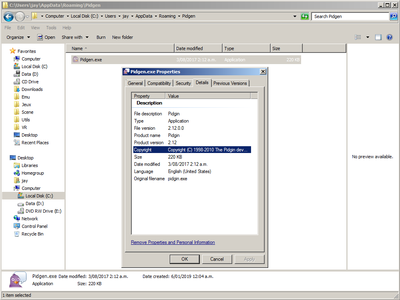

/Users/jay/AppData/Roaming/Pidgen/Pidgen.exe exists but I won't upload it here for obvious reasons. It shows the icon for the chat client Pidgin (note: two 'i's and no 'e') and even reports itself to be copyright the Pidgin dev team in the exe properties, but it's misspelled and I certainly never installed that client. It also doesn't show up in add/remove programs.

It looks like the exe/vbe combo was created back in January which is more-or-less when I first set this Windows install up. I also found it in the same location in the archive of the previous machine that this one replaced.
Windows Defender scan with updated defs finds nothing. There is a legit Windows component called PidGen, but I seriously doubt it would be run from a VBE script in the start menu & this whole thing looks super shonky. Searching the HDD for "pidgen*.*" yields said exe, the vbe launch script, a few references to the Windows service (pidgenx.dll), and a whole bunch of crash reports & dumps for Pidgen.exe.

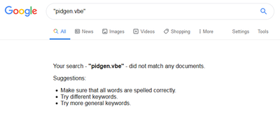

Searching Google or DuckDuckGo for "pidgen.vbe" yielded no results. Well, now they'll probably find this thread.
