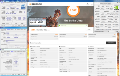

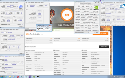

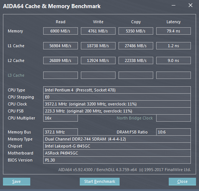

Reply 3 of 4, by agent_x007
You can abuse 4GB of RAM :
87.11 KiB
201 views
88.16 KiB
201 views
PCI-e GPUs :
528.98 KiB
201 views

Even NVMe SSDs (second PCI-e slot required, if you need PCI-e GPU) B)
