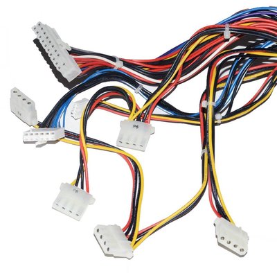

I recently acquired a Dell Dimension V333c, a 333MHz Slot 1 Celeron based system. The problem I've found is that it uses a PSU with a sort of half AT motherboard connector design that connects alongside the standard 20-pin ATX connector. The second problem is that the PSU in question is toasted (though it did come with it- model number of the PSU is PS-5201-7D). The system won't even so much as spin the fans without that extra connector hooked up, it seems. Are there any options for me to jerryrig a solution using spare parts or will I have to go out and buy the same model of PSU on eBay?

The cable that the PSU itself uses to interface with this fully standard and not dumb at all connector design is the weird AT looking thing with the blue and black wires:

Reply 1 of 5, by Katmai500
Unfortunately the ATX connector is also proprietary when it comes to the pinout. Dell did this in the late 90's. On the intel version of that board the connector would be shifted to the left on those six empty solder pads. It's my understanding that powering up this board with a standard ATX PSU connected can fry the motherboard. You can buy adapters for standard ATX to dell pinout, but it may be too late if it's been tested with a standard ATX PSU. 😢

Here's a source in the pinout of the connectors: http://www.informit.com/articles/article.aspx?p=339053

Luckily, those adapters are very cheap.

Reply 3 of 5, by oeuvre
cheapest one I can find on eBay https://www.ebay.com/itm/200W-Dell-OEM-Power- … NG/192984497516
Reply 4 of 5, by Thermalwrong
If you feel like soldering, I converted my Dell AL440LX board into a regular AL440LX board by desoldering the ATX connector and moving it across 😀

oeuvre wrote:
And here is an adapter cable if you want to use a new standard ATX PSU: https://www.ebay.com/itm/322554738480
