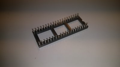

I have this breadbin Commodore64 (old model) that uses a 12volt VIC-II video chip. And I wanted to be able to use a 5volt VIC-II chip in it. The reason is that the 12volt 6569 VIC-II chip, have an inferiour picture quality, compared to the 5volt 8565 VIC-II chip. The difference is higher contrast on the new chip yet the major downside is that it introduces some kind of vertical jailbar's. Those will be extemely visible on a flatscreen TV, yet that can be solved, using a Lumafix64 mod. (that belongs in a totally different tread, if people here do not know it and want info on it)
Anyway....
With a "new" VIC-II combined with a lumafix and the old SID chip. You pretty much get the best of both models. And you can maintain the original Breadbin case with it's original motherboard. And so I did some tinkering with my solder iron today.
Some time ago, I did a prototype....
here and here
And today I did the final product.

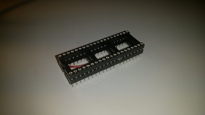

Rasped off Pin13 on the bottom part...

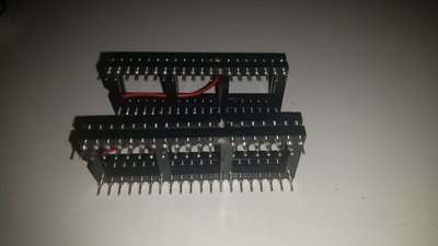

Soldered a wire between the pins, feeding 5volt to pin-13...

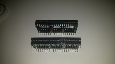

Sandwiched them together, and now it can be used to run the Breadbin model with C64-C VIC-II GFX Chip.

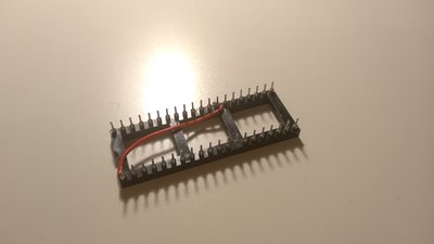

I made two while I had the solder iron heated up... Shot from one side.
270.98 KiB
197 views
And a shot from the other side. (why not?)
I hope this will be at some help to others, that are for some reason in the need to run a 8565 on a 6569 compatible board....
