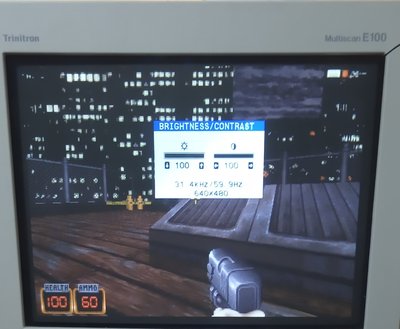

The other thing I noticed that, when I start pc, on post screen the monitor reports 640x350, on ms-dos command line the monitor reports 720x400, in a 320x200 game the monitor again reports 720x400, in a 640x480 game it reports 640x480. I always thought that ms-dos shell was 640x480? And why the crt in 720x400 mode while the game is in 320x200? I mean, why can't the crt be in 320x200 mode? is it the vga card that sends 720x400 while in 320x200 game, or is it the crt that makes the conversion(I don't think?) ? and why?
Reply 4 of 11, by alvaro84
The monitor has absolutely no idea about the horizontal pixel count through a VGA cable. It only knows that the signal carries 400 (visible) scan lines per frame and synchronizes its horizontal scanning speed to this rate. Then it draws everything that comes through the cable when it comes through.
So it doesn't know or care if it gets 720x400 (text mode) or 320x400 (320x200 mode) because the pixels are just unknown time spans of a continuous analog signal. The 200 scanlines are doubled by the VGA card and sent to the monitor that way.

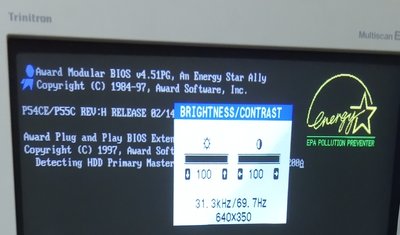

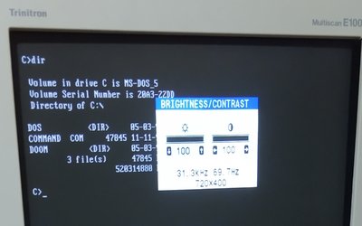

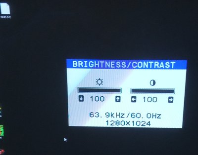

Here, I attached some photos. The 1280x1024 and 800x600 are fed from 2007 laptop, others are fed from p-200 system with s3 pci video card.

Reply 6 of 11, by alvaro84
mhdbox385 wrote:
Why does is it even report horizontal resolution then? Why not just report "400 lines" or something?
I think it doesn't. These are the monitor's guesses and it just has no way to tell the horizontal resolution.

Not just guesses. It knows the vertical and horizontal refresh and it knows the number of horizontal lines - so it can infer the horizontal resolution from them.

Just guesses.
Indeed, HSYNC frequency divided by VSYNC frequency gives (more or less) the number of horizontal lines, ie. vertical resolution.
But there's no pixel clock signal on the VGA connector, so no way for a monitor to know the number of pixels per line.
Monitors can only assume the most common horizontal resolutions:
350 scanlines usually means 640x350
400 - 720x400
480 - 640x480
600 - 800x600
768 - 1024x768
1024 - 1280x1024
1200 - 1600x1200
Yes, since around 1994, BIOSes use the 640x350 graphics mode to display that "Energy Star" logo, even though eg. CMOS Setup displays in 80x25 text mode.
If you mean the command line, then it defaults to 80x25 text mode, and on VGA, characters are 9x16, therefore 720x400.
CGA monitors only support 200 scanlines.
EGA monitors - 200 or 350.
VGA monitors - 350, 400, or 480.
So, on a VGA, the card has to double-scan the 200-scanline modes, and when the monitor detects 400-scanline, it assumes 720x400.
