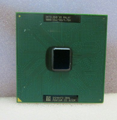

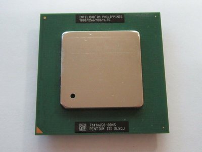

Reply 6 of 14, by Bige4u
You have one or the other to choose from... die exposed or one with IHS(integrated Heat Spreader).

Reply 7 of 14, by precaud
Thank you for the generous gift! Since i already have one with exposed die, I'll take the IHS ! 😀
Reply 8 of 14, by Bige4u
precaud wrote:
I think you misunderstood... i was just showing examples of the Pentium3 1ghz/133 cpus that were made that you could choose from, one with die exposed, the other with the IHS, i wasnt offering to send you one. Sorry
Pentium3 1400s/ Asus Tusl2-c / Kingston 512mb pc133 cl2 / WD 20gb 7200rpm / GeForce3 Ti-500 64mb / Sound Blaster Live! 5.1 SB0100 / 16x dvdrom / 3.5 Floppy / Enermax 420w / Win98se
