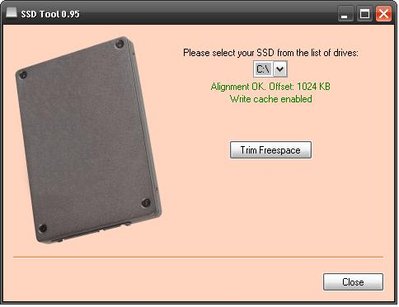

Reply 14 of 17, by Shagittarius
I've been using this, can't remember where I got it but it seems to work to me...even if it doesn't I feel better.
ssdtool.exe
849.5 KiB
1673 downloads
I use with XP 32bit
    22.85 KiB
    13388 views
ssdtool.exe
A quick search for the tool on Google led me to this website. Apparently the author of the program was a user on the Crucial SSD Forum, which now ceases to exist as a forum.
Just like the previous tool, in fact on a greater scale, this tool also felt... underwhelming. I know, TRIMing under Windows 10 feels about the same way, but at least under 10 when you "optimize" your drive and you see the percentage of the drive currently TRIMed, you feel like it did something. This? No such feeling. 🤣
I'd say with both of these SSD tools, there is no way that I know of to measure whether or not they did their job or not. If there is some way I can verify that they actually work, especially compared to Windows 10's TRIM functionality, then I'd be willing to test them and do a comparison.
I think, though, that these tools must do something, so I'll run these tools once in a while, and then once in a blue-moon (a few months) I'll pop the drives out of the machine and throw it into my old craptop to let Windows 10 "officially" TRIM it. Can't hurt, right?
