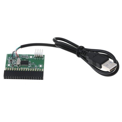

Is there an adapter available that will convert a standard 3.5" floppy drive cable connector to a 5.25" floppy drive cable connector?
I am asking because I have found an adapter that converts a 3.5" floppy drive to USB via an internal connection to a USB 2.0 header. I want to do the same thing with a 5.25" floppy drive, but, of course, the connector for the 5.25" floppy is not compatible with this USB adapter.
Therefore, I am looking to see if there is a adapter that will connect between the standard 3.5" floppy cable and the 5.25" floppy drive.

I updated my original post to include a picture of the USB adapter. I need something to convert the 34-pin "cable" shown to allow it to plug into a 5.25" floppy drive. Thanks.
Reply 4 of 14, by PC Hoarder Patrol
Wouldn't be hard to make your own - all you'd need is a short length of old floppy cable with a suitable 34 pin female edge connector at one end and a 34-pin male IDC ribbon connector at the other.

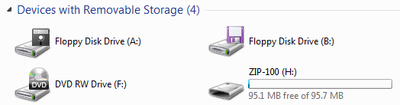

Seems like a missed opportunity, if it doesn't play ball with 5.25" drives. Of course, I used to use a 5.25" floppy drive with my Windows 7 system, but its motherboard still had a floppy connector.

1) USB 5.25" drives have existed, but they're extremely rare. ( http://www.deviceside.com/fc5025.html )
2) Generally external USB 3.5" chipsets don't support 5.25" drives, but I can't speak to this one as I haven't seen it before. So you probably won't be able to use it with a 5.25" drive.
But if you do, let us know where you got it so we can buy them out of stock!

Theoretically you could create a coupler using 2.54mm header pins so you can just plug an old FDD cable into it
They can be cut down to the correct length using wire cutters and the blank pin can be pulled out with pliers, might be worth addig a couple of cable ties to hold it all together. The main question would be whether one of the USB adapters would support a 5.25 drive, I've looked at them in the past when I've thought about adding an internal 3.5" drive to my modern computer.

I've seen adapters to connect 3,5" fdd to 5,25" fdd ribbon cable (in fact I have at least 5 of them), but the other way around - nope (it doesn't mean they don't exist of course).
