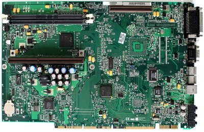

Reply 7 of 9, by Thermalwrong
You could consider the NLX form factor motherboards. Those have the AGP slot on the board's edge and implement additional slots with a riser card on the side of the board. Not quite the right time period for a Voodoo 5 5500, but probably the only type of motherboard to have both features. I'm also not sure it can physically fit such a card without significant modification, because there are ports where the edge of a regular AGP card would fit. The NLX standard died out quickly for a reason 😁
Now that's a bit too exotic even for me 🤣
I think I'll just stick with two expansion slots or standard mobo with riser decoration, if there are no other options - or maybe I'll just abandon the idea altogether...
