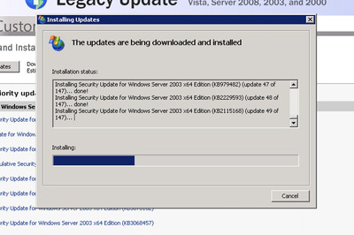

Head straight for Windows Update. In IE you will need to enable TLS 1.0 (Settings->Advanced tab->Security).
This will take a long time to even determine what updates are required. Detection after the first round of ~150 updates will be much faster.
Getting the first round of updates to install can be tricky - if you see a taskbar notification indicating that "Updates are ready for your computer", you can abandon IE and use that opportunity to install the first large batch of updates.
"There's always a few more.." run the update detection in IE several times, rebooting every time you install more updates. Once you've completed role installation, it's wise to do another couple of update passes. You can stop once all updates are installed.

Windows Update (2000, XP, 2003)
Now that much has changed from my original post - you will need to do some additional work to get either WU, and/or Windows Activation working.
There's a couple of giant threads on MyDigitalLife and MSFN on this topic, but I chose to start with this:
https://github.com/kirb/LegacyUpdate
..which is hosted at https://legacyupdate.net
After taking a look at the ActiveX code and the Privacy Policy, I felt that it was pretty reasonably sane - do what's necessary to restore the windows update frontend, but actually get the update bits from Microsoft.
And, well, yeah - after installing the client and then waiting a bit for update detection, both my Server 2003 x64 test system and the "real" one got all the updates I believe they should..
135.22 KiB
2445 views
There are other methods that seem to act more as a MitM, WSUS "proxy" of sorts; but this solution actually seems to restore the functionality of the original. This may overall be "safer" as now we're relying on legacyupdate.net to be up and running. However..we're not exactly dealing with a moving target: updates for all of these systems are done..final. So for XP or 2000 clients? I'd still run with the update packs that are already really well figured out (and a huge time saver anyway). But for this server on the other hand Legacy Update is a huge help.
Reply 10 of 11, by chinny22
https://legacyupdate.net That web site is beautifully designed both nostalgic and clear and simple....oh how i miss those days.
While I agree with the statement not much point fully patching an OS that hasn't had any new hotfixes in the last few years I can appreciate the nerdy retro sys admin side of projects like this.
