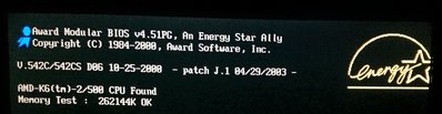

Hi all. I am trying to update the BIOS on a Jetway J-542C and am having problems. The current BIOS is D05 and I understand the latest is D06. AWDFLASH.EXE gives the following error:
"The program file's BIOS lock string does not match with your system"
The BIOS file is 542cD06.BIN. I have also tried flashing the hacked 542CD06J.BIN version with the same result. I have tried two different versions of AWDFLASH with the same result.
Is there some command line parameter for AWDFLASH that needs to be specified?

"No check BIOS Lock". That option isn't listed in the AWDFLASH /? usage page. I assume it was left out because its risky?
ETA: this is the best description of the program options I've found, though it's in Russian: http://wiki.rom.by/index.php?title=AwardBIOS_Flash_Utility

Reply 3 of 7, by Errius
Thanks, that did the trick

Reply 4 of 7, by AlaricD
Undocumented switches abound! Indeed, it is pretty risky because basically it lets you flash any ROM you please whether it'll work or not.
You're welcome! I'm glad to help!
