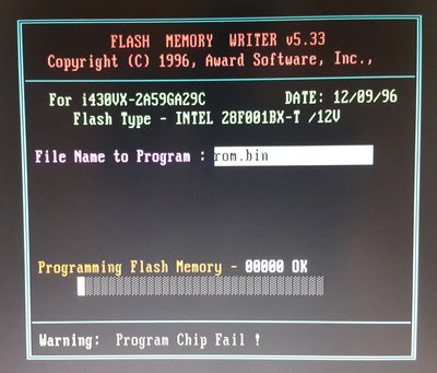

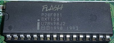

I'm trying to flash the BIOS of ATC 1020 but it fails 😕
JP19 has set as pins 1 & 2 closed too.
    124.31 KiB
    85 views
    455.18 KiB
    85 views

U can try uniflash it never failed me, could also be a bad chip.
