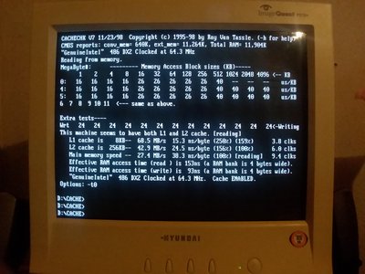

I removed the cache chips from the sockets, blew out the sockets with canned air, and re-installed the cache, and the error has not subsided. I do not know how to identify which chip is damaged in this case. Once I can identify the chip, I will be forced to reduce system cache down to 128KB without the damaged chip. I have some other 20ns L2 cache, but it is not the same kind that is installed with my 9-chip configuration, which likely means that I will be unable to simply "swap out," with the other memory chips.

I changed out some of the top row of chips with the Samsung chips, and HIMEM.SYS no longer reports errors when the system is set up with 256KB of L2 cache, so I'm pretty pleased with those results. I ran CACHECHK, and while I'm not sure how to read the results, this is what it shows when it gets done running:
