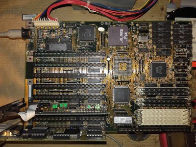

I managed to obtain an original motherboard of the BIOS UV-EPROM chip that I wrote about here: BIOS image collection - requests, discussion etc

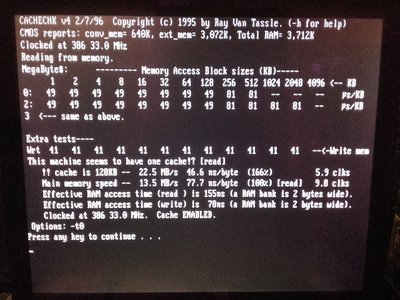

The motherboard seemed badly damaged by a leaky battery at first, but after cleaning the corroded area, it didn't look too bad. Overall, had to patch 8 open traces and replace all contacts in the KB controller's DIP socket. MB succesfully POSTed at the first try. It had badly configured L2 cache at first (different size SRAM ICs and wrong jumper settings), also, 2 SRAM ICs in BANK1 were faulty. Anyway, reconfigured L2 cache and PC loaded command prompt W/O hanging. I was able to bench MB with DOOM and other software properly, cache check showed right ammount L2 being installed.

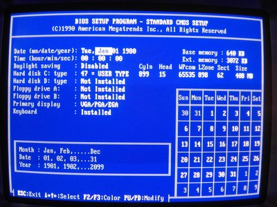

But after some time, MB started to hang in DOOM timedemos and crash, even when starting a scandisk... Cache check wouldn't pass either, it just kept crashing. Set L2 timings from 0WS (default) to 1WS, cache check would then pass, but DOOM still kept crashing the system. Long story short, it was nor RAM nor cache related, I've noticed one bizzare thing in the CMOS settings:

Can you spot what's wrong here? 🤣
Hint -> RTC time keeping clock had stopped working.

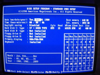

Every time the system crashes, clock increments by one sec:

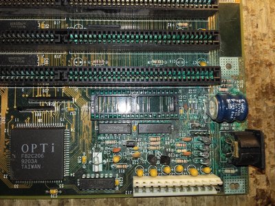

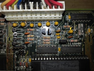

I've inspected the corroded area once more, checked every VIA and trace again, found nothing, except for a bad Q2 transistor, which is a part of a switch that feeds +5V to the RTC clock gen. circuit. Replaced the transistor, clock gen. circuit now receives proper +5V voltage, but clock in the BIOS still doesn't work.

Could these crashes actually be caused by a non-functioning RTC time keeping and if so, why??? First time dealing with such an issue.

When RTC is stopped it means the 32768Hz crystal isn't oscillating, so I would check the stuff tha tthe crystal is connected to. Chances are that the 82C206 chip is faulty too, which is where the RTC itself lives in but seeing this battery damage, I'm pretty sure the problem in mechanical in nature.

Okay, I've figured out both problems for the clock non ticking in CMOS and constant system crashes. Clock problem was caused by the absence of RTC clock oscillations (obviously), a 10pF cap (C30) next to the quartz resonator had become a 8M resistor, most likely it had soaked in alkaline electrolyte through the leg cracks.
The constant crashing problem was caused by a open "POWER GOOD" trace... I had it repaired the 1st time, but somehow missed a weak spot in it, just behind a KB connector (two black specks can be seen), so that trace had reopened and all hell broke loose 😠
It lives now, installed 128KB of L2 (BANK0 4x 32Kx8)

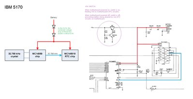

Thanks, it was easy to figure out why the clock wasn't ticking, but it made no sense to me that it could cause such system instability. I had C30 replaced with a 27pF cap at first (27pF is used in most systems, IBM 5170 used it originally too), but it caused clock to tick 2 or 3 times slower than it should, kind of strange, considering that RTC clock gen. circuit used in that MB is identical to that of the 5170, crystal resonator might also be slightly off the specs.
Here's a clock gen./battery circuit from a 5170, hosted at -0°:
