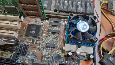

Welcome Martin 😀
Here is a report of my (freshly installed) Abit PH5 (SiS5511 + 5512).

Thanks! Looks quite good to me, the only issue I need to fix is that the VGA is reported twice. But I can access its internal registers well, so that's nice 😀
The drive wasn't identified because IDE scan is set to Safe mode, switching to Low-level IO Access might do it.

OK. The system uses a CF to IDE converter, FYI.

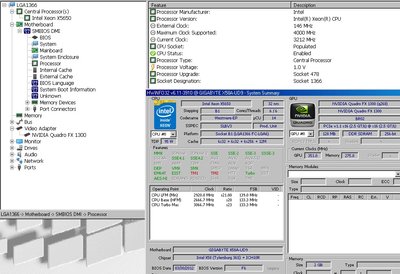

Too many cores/too little threads (HT was active, however Win98 can only do 1 Core/1 Thread max.).

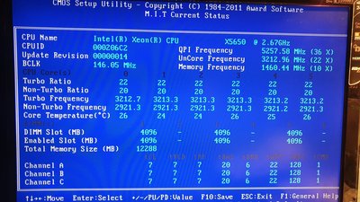

Settings :

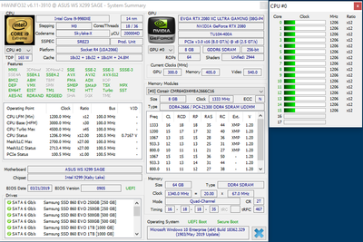

Why, it's reporting the number of L1 + L2 caches the CPU has rather than what is being used, SIV reports the same, but only shows one CPU as this is what Windows 9X supports.
Out of interest what does the CPU #0 panel report? I suspect there will be 6 cores, but 5 will be greyed based on what HWiNFO32 does on this system. Obviously HWiNFO64 shows all 18.
file.php?id=68245
    92.51 KiB
    30324 views
    16 of 18 cores
