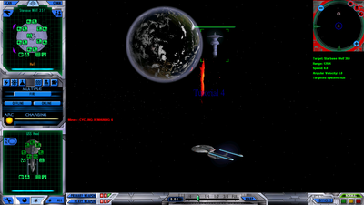

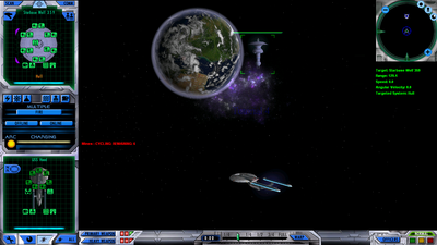

DGvoodoo2 works for Starfleet Command III from 2.7 until 2.73.
Since 2.74 there will be some color weirdness on UI, planets and space background. But this is only observed with AMD radeon graphics.
This is normal screenshot in 2.73
The attachment SCR00000.png is no longer available
This is in 2.74-2.75.1, note upper-right ui showing weird red color, the planet seems using 16-bit or 8-bit color.
