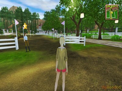

Reply 2 of 3, by ZellSF
OP: The first step you should always try is running with a clean config (copy dgvoodoo.conf from the dgVoodoo zip to the game directory).
Barbie Horse Adventures Riding Camp is D3D9 and renders 3D fine:
The attachment dgvoodoo.jpg is no longer available
Some effect is definitely missing though:
The attachment native.jpg is no longer available
