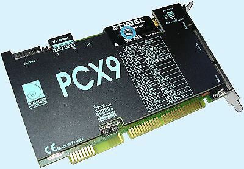

Is this a good or desirable sound card? I've never seen anything like this for ISA..
Reply 1 of 2, by Tiido
It doesn't seem to have any DOS support and for Windows it seems to only have MME support so it will also have limited use in games. These cards seem to be for industrial purposes. It would be nice to see what's under the cover though.
Reply 2 of 2, by gdjacobs
Indications are that this card supports AES/EBU digital I/O, so it would be useful for broadcast and studio work.
