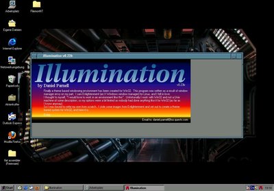

Reply 5 of 11, by Jo22
In case of visual styles, there also was Illumination..
Just tried it out a few days ago when I saw it being mentioned at Wikipedia.

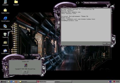

Edit: Here are some pics, too.
Edit: "Nostromo" wallpaper can be found here.

Reply 9 of 11, by Jo22
Lazar81 wrote:
Looks like the download link is dead. And my antivirus program getting wild when I try to enter the site.

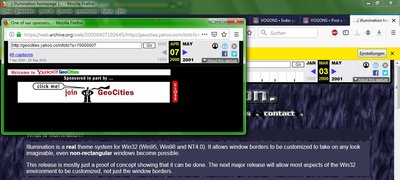

Yes, it's dead. On the archived version. The WebCite page hasn't archived it. Wayback Machine should be fine, though.
Here's the link for year 2000 captures:
https://web.archive.org/web/20000715000000*/h … lumination.html
As for the viruses, I'm not sure what to recommend (sorry 🙁 ). My antivirus (Avira) didn't say a word yet.
However, there's a pop-up (Yahoo ad) that gets blocked by Firefox (see attachment).
The Illumination program itself does work, though.
The previous photos were taken from my Win98SE VM. 😀
