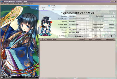

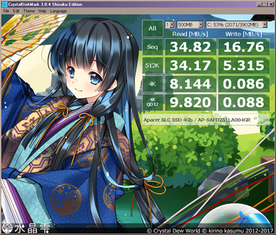

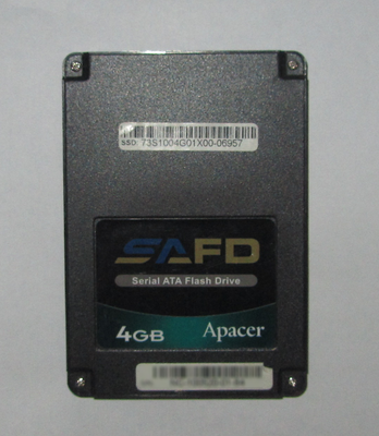

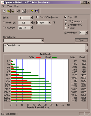

Apacer 4Gb SAFD251LA004GR:
1.81 MiB
3886 views
721.51 KiB
3886 views
973.04 KiB
3886 views
12.6 KiB
3886 views
Old and venerable industrial SLC based drive. Quite slow, but should be enough for something like a 430FX.

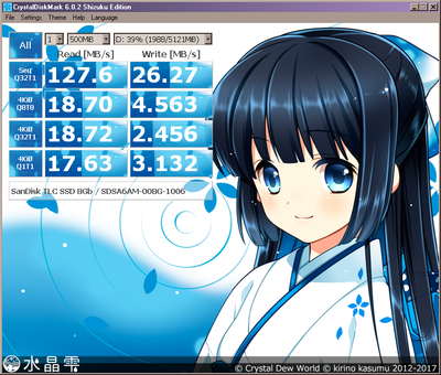

Reply 1 of 31, by The Serpent Rider

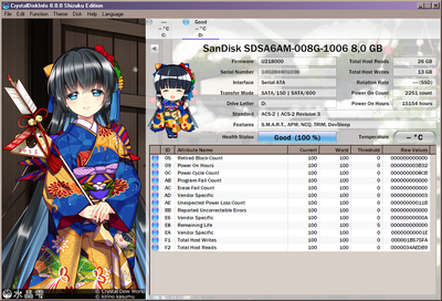

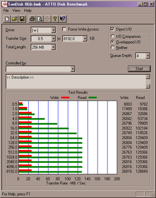

Sandisk SDSA6AM-008G:
673.58 KiB
3885 views
746.56 KiB
3885 views
543.57 KiB
3885 views
20.51 KiB
3885 views
Mostly fresh TLC (I think) based drive which was scavenged from a printer. Fast on small blocks, but may be problematic to use without TRIM in the long run.

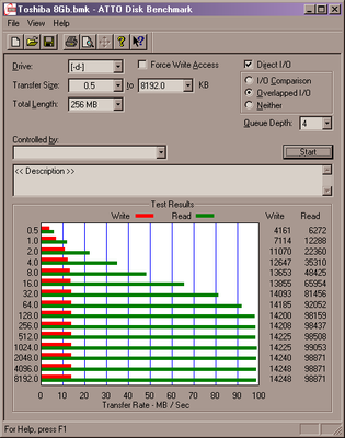

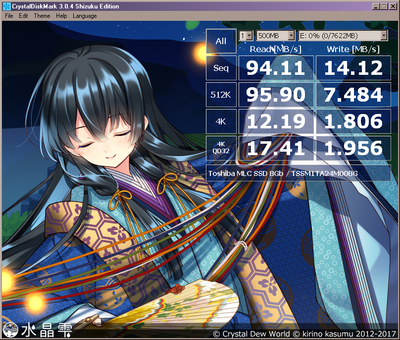

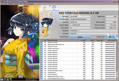

Toshiba MLC based SSD TSSM1TA24M008G (manufacturer unknown):
808.76 KiB
3884 views
669.81 KiB
3884 views
1 MiB
3884 views
20.13 KiB
3884 views
Fairly slow NAND memory, which was mostly used in el cheapo USB sticks. Still, easily can compete with an old SLC drive.

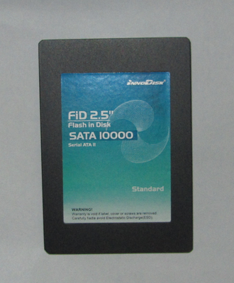

Reply 3 of 31, by The Serpent Rider

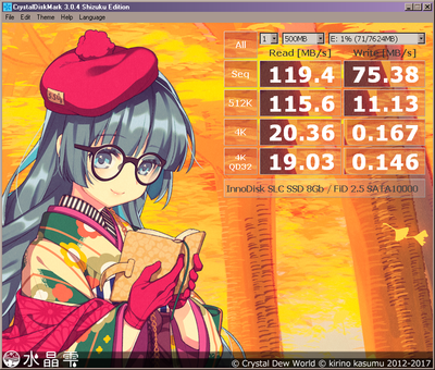

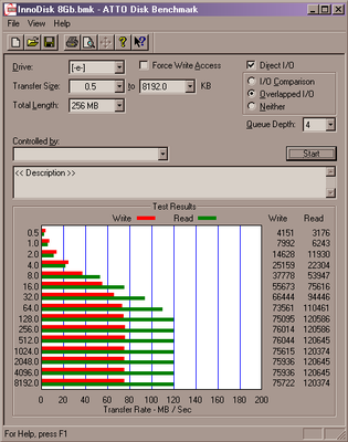

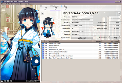

InnoDisk FiD 2.5 SATA10000:
1.09 MiB
3879 views
703.36 KiB
3879 views
1.05 MiB
3879 views
1.06 MiB
3879 views
12.69 KiB

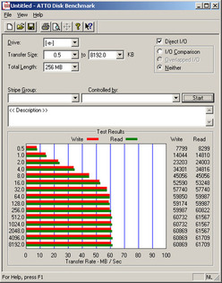

3879 views
Very fast 8Gb SLC based drive, at least when it comes to sequental writes. For some reason does not like lots of random small blocks in CrystalDiskMark. Shouldn't be a problem in real scenario though.

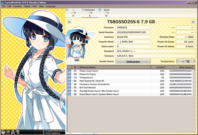

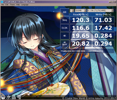

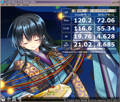

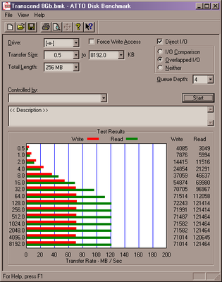

Transcent TS8GSSD25S-S:
1.44 MiB
3879 views
419.58 KiB
3879 views
1 MiB
3879 views
1 MiB
3879 views
20.39 KiB
3879 views
Almost identical to InnoDisk SATA10000.

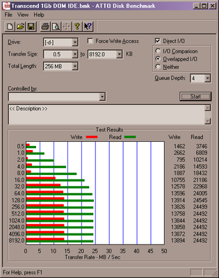

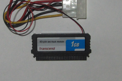

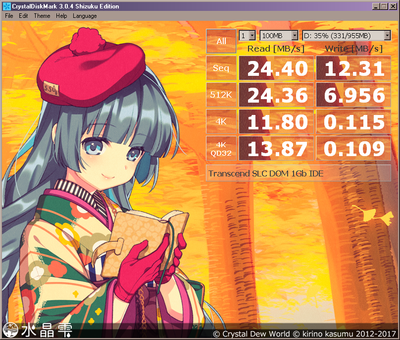

Reply 5 of 31, by The Serpent Rider

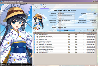

Transcend 1Gb 40-pin IDE Flash module (circa 2011?):
863.37 KiB
3857 views
546.16 KiB
3857 views
1.06 MiB
3857 views
20.23 KiB
3857 views
Strange behavior on a few small block writes (ATTO), but overall not bad for 1Gb SLC (maybe) drive.

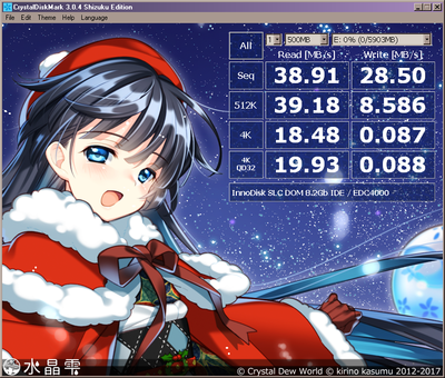

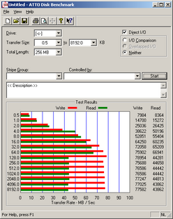

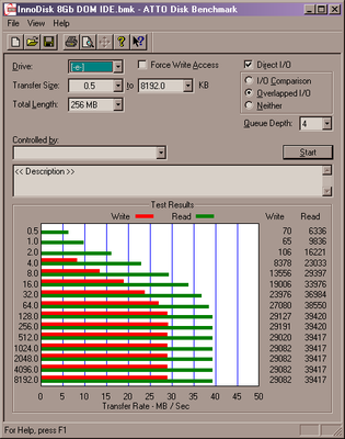

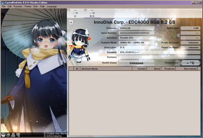

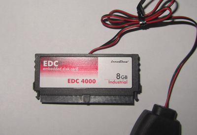

InnoDisk EDC4000:
927.12 KiB
3857 views
744.85 KiB
3857 views
879.94 KiB
3857 views
19.73 KiB
3857 views
Veeery slow on small blocks (CF cards levels of bad), but starting from 4k blocks speeds up quite decently. Most likely common problem of large PATA DOMs. SLC based.

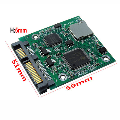

This site had lots of good info about the limits for the different chips used in the adapters.
https://thechipcollective.com/posts/cynical/ewaste/
I found it when I was looking at the SATA-SD adapters on ebay and noticed that it was a two chip implementation using chips I already have. Here is what they had to say about the performance of the two chip device:
Consulting the datasheets reveal how it works but not why it’s so slow. The JM20330 is a SATA to PATA bridge, and the FC1307A is a CompactFlash to SD adapter. Since CompactFlash cards can run in ATA mode and are essentially tiny PATA SSDs, the two adapters can be chained. This occurs within the board, hence the large parallel bus visible between the chips. The SD card is converted to PATA which is converted to SATA which does indeed create a SATA SSD. It’s extremely shit and outperformed by an X-25M, but it is technically a SATA SSD.
The JM20330 was released in 2003 if we go by the datasheet’s publication date. SATA was only three years old, and lots of PATA drives were still floating around, so it made sense to produce a bridge that allowed the use of old drives in new systems. It supports ATA/ATAPI-7 and UDMA 6, giving it a 133 MB/s parallel ATA bus and a 150 MB/s serial ATA bus. That shouldn’t be the cause of any slowdowns4.
The FC1307A appears to support UDMA 6 on the host side, the same as the JM20330 (though the datasheet only claims ATA/ATAPI-6 compatibility). On the device side it supports SDHC 2.0, which allows cards to run at 25 MB/s. This still doesn’t explain the slowdown because that’s six times the transfer rate benchmarked5.
And individually, neither chip is slow. A series of tests indicates that the FC1307A is able to sustain 24 MB/s6, and although there are no real benchmarks of the JM20330 by name, there is a claim that it can hit 30 MB/s with a hard disk drive7. It’s definitely the combination of the two chips that’s causing the issue, and JMicron’s apparent inability to make good chips involving SATA doesn’t help.
Avoid this. Never buy this. This is a terrible, terrible piece of e-waste. It never should have been made, and it was made to be tossed into a landfill.

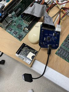

Reply 11 of 31, by douglar
I was seeing if there was any easy way to get around the 25MBs bottleneck on the FC1307A chip commonly used in IDE-SD adapters.
I tried connecting an IDE to USB adapter with a USB to flash adapter.
It worked in DOS. Win98se was not happy with it though. It didn't get past the loading screen, even though the color cycling at the bottom of the screen kept running and num lock still worked.

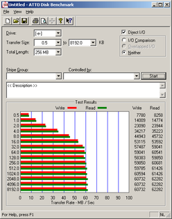

I can't yet speak for the JM20330 (got some on order), but its little brother, the Jmicron JMD330 is no slouch .
This is in P3 1400MHz 512K system with an i815ep/ICH2 ATA66 controller and Jmicron JMD330 hooked up to a Samsung 860EVO (so the drive is not a bottleneck) and running Windows 98 SE.
It's even faster on a Promise Ultra133 TX2 (90MB/sec read in HDTACH 2.61, did not try ATTO)

While some people have gotten a lot of free time from the quarantine, I have not. Really sidelined my storage benchmarking project.
One thing I've learned is that some of those cheapo counterfeit SD cards you can get from the grey market have some truly atrocious throughput and uneven performance. I got a knock off Samsung 128GB micro sd that maxes out at a 7MB/s transfer rate and it rarely sustains that for any length of time. Wasn't worth $15. It's a bottleneck even on a 486.
While I like the thoroughness of ATTO for bench marking, it's tough to compare because there are so many data points.
Has anyone used MS-DOS Disk performance tester, by James Pearce ? https://www.lo-tech.co.uk/wiki/DOS_Disk_Tester
I like the 4 tests that it has:
  • 32K Sequential Read (KB/s)
  • 32K Sequential Write (KB/s)
  • 8K Random (IOPS) - 70% read, 8K aligned
  • 512-byte (single sector) random read IOPS, sector aligned
Lack of DMA support for many IDE interfaces under DOS (at least without using UDMA.SYS and friends) means PIO mode is a common bottleneck for most devices . To be representative of actual max device performance, DMA mode would have to be enabled manually where not done automatically.
Reply 16 of 31, by darry
This is, again, in a P3 1400MHz 512K system with an i815ep/ICH2 ATA66 controller and Jmicron JM20330 this time hooked up to a Samsung 860EVO (so the drive is not a bottleneck) and running Windows 98 SE.
13.2 KiB
3318 views

Reply 19 of 31, by darry
The Serpent Rider wrote on 2020-09-24, 02:37:
darry wrote on 2020-05-21, 22:08:
ICH2 is ATA100 though.
You are absolutely right !
After installing the drivers from the installation CD of my industrial board and getting results consistent with ATA66 , I never bothered checking .
The results were as follows :
126.16 KiB
3110 views
After reading your post and checking the datasheet, I downloaded and ran IATA_CD.EXE which updated my driver. I then ran a test which gave the following strange results . I also tried running a test with HDTACH, but that crashed the system with the new driver, so I rolled back .
20.72 KiB
3111 views
