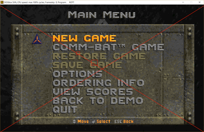

While investigating bug 515 https://sourceforge.net/p/dosbox/bugs/515/
I found that the bottom triangle of the quad is under certain conditions misaligned with the top one.
However, so far it seems to be specific to NVIDIA and only for certain resolutions.
The game in question is Rise of the Triad
The B on the title screen
95.52 KiB
1043 views
When it is wrong, it is either:
2 KiB
1043 views
or
2.87 KiB
1043 views
(the triangles are joined on the line bottom left to top right, I assume)
It happens for:
output=openglnb
aspect=false
scaler=none
windowresolution=1680x1050 (also with scaler=normal2x and normal3x)
or
windowresolution=1440x900 (both none and normal2x)
or
windowresolution=1200x750 (normal3x)
or
windowresolution=720x450 (none)
Can somebody try it on an AMD card ?
Does anybody have an idea on what is happening ?
I have a fix, but it slightly changes the output and I am not sure if I should do it always or if there is some pattern and if it should be done for bilinear mode as well ?
I am not that familiar with opengl, so feel free to suggest other ways to fix it

This gave distortion on the other diagonal (see screenshot, the red lines show the 2 diagonals and are drawn by me, not the game 😉 )

However this weird "trick" does work!:
		glBegin(GL_TRIANGLES);
// upper left
glTexCoord2f(0,0); glVertex2f(-1.0f, 1.0f);
// lower left
glTexCoord2f(0,tex_height*2); glVertex2f(-1.0f,-3.0f);
// upper right
glTexCoord2f(tex_width*2,0); glVertex2f(3.0f, 1.0f);
glEnd();
Making one big triangle and draw in the square 0,0;0,width; height,width;height,0 (so 2 parts of the triangle are unused)
The height,width point is on the diagonal of the big triangle.
Not sure if it is better or worse than the workaround of the first post.
