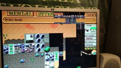

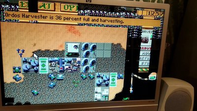

So here's the situation:
I have a Commodore 386sx bridgeboard upgraded to a 486slc ( or something like that ) with a Math.co 387sx fpu and 4mb ram.
All seems to work fine apart from Dune2 where the graphics go bad ( see pictures ). I use the uncracked cdrom version, 1.07 ( with or without 1.07fix ) and it happens both when I play from HD or straight from cdrom. I tested 3 vga board, removed the fpu, turned on/off the cpu cache and/or clockdoubling, turned of vga and bios shadowing ... to no avail. Also the setup program tends to go bad at moments with funny characters in the text. Ingame it seems to be the scrolling that evokes it.
I am really lost here, I also considered that maybe the cpu gets too hot despite having a big heatsink on it but considering the fact Dune 1 with it's fancy intro and animations runs just fine I doubt it. I also have 612kb of base ram free while it says it needs 602kb and I get the message "taking advantage of extra ram" when I start it.

Reply 1 of 10, by CBM
my guess would be bad memory sticks in your retro system
also, you can try to run dune 2 on a more modern computer by using winuae.. the amiga version is superior anyway in my opinion 😀
I would also recommend to use something like memtest86 to test the memory of your retro pc system

Reply 4 of 10, by SimonV
I have 3 different bigbox releases for AMiga on my bookshelf ... but telling me to use a modern system is kind of missing the point of me wanting to do some retro computing no ?
I guess I can test the memory although why would it only happen in one game.

Reply 6 of 10, by derSammler
Guys, you all miss the point:
Like the Janus docs tell you, using the mouse driver for the bridge board can destroy the on-screen graphics. This is a bug in the Janus software and there is no way to fix it, other than connecting a mouse using an i/o card.
Reply 7 of 10, by SimonV
I really think something else is going on here. For instance I can't start Day OF The Tentacle anymore while that worked just fine before. I wonder if memmaker changed something in config or autoexec that causes it.
Reply 8 of 10, by derSammler
I don't think your problem with Dune II has anything to do with DotT. Graphics corruption is a side-effect of AMOUSE, and that is told by Commodore itself. You can try to disable CPU caches on the Amiga side, that may solve it, but it's not a suitable solution if it does.
As for memmaker: never use that piece of sh*t. It's the worst "memory optimizer" I've ever seen.
Reply 9 of 10, by SimonV
Well you are right. Did a clean dosinstall with just amouse installed and as soon as I enabke it, the problem begins. Damn. I guess I have to swap the ide cache controller for a standard multi i/o controller.
