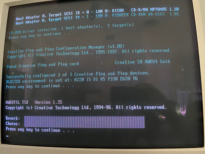

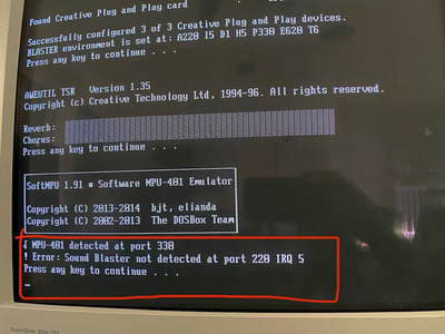

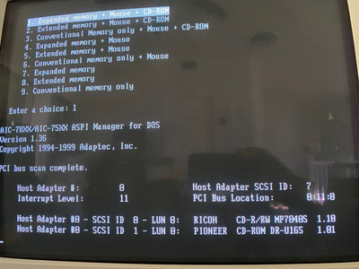

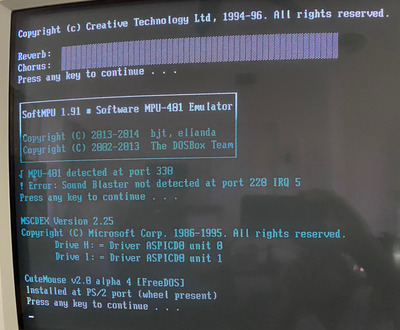

UPDATE:
I just replaced my IDE CD-ROM drive with a SCSI one, on an Adaptec AHA-2940UW PCI adapter. Whenever I boot the system, I get this error message:
MPU-401 detected at port 330
! Error: Sound Blaster not detected at port 220 IRQ 5
This is my current SOFTMPU.EXE entry in Autoexec.bat file:
LH C:\UTILS\SOFTMPU\SOFTMPU.EXE /MPU:330 /SB:220 /IRQ:5
Also the Blaster environment loads at is set at: A220 I5 D1 H5 P330 E620 T6
I haven't touched my sound card at all, I am not sure why I get this message. Any help would be appreciated!

Reply 4 of 10, by vetz
What kind of display adapter do you got in the system? I know this might sound strange, but PCI bios settings can cause ISA cards to lockup the system or not be detected.

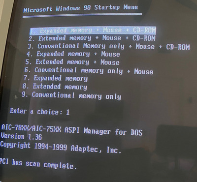

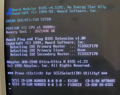

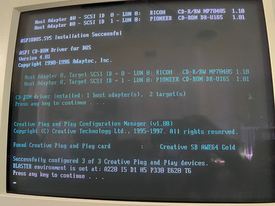

Reply 5 of 10, by C0deHunter
These are the messages in BIOS / DOS:
I am using Phil's Computer Lab DOS menu.

Reply 6 of 10, by C0deHunter
And the last two messages:

Reply 8 of 10, by dionb
Hmm, sounds like PnP hell. Does your BIOS let you see IRQ allocation for PnP devices? Wouldn't surprise me if the AHA-2940 is conflicting with the AWE64 somehow.
Perhaps you could try moving the AHA-2940 to a different PCI slot.

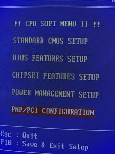

UPDATE:
I just ran AWE64 DOS based diagnose utility, and it fails at setting IRQ 5 to my card. I even moved the Adaptec to a different PCI slot, and it did not help.
UPDATE2:
I think I have isolated and fixed the issue, went into the BIOS, and under the Resources Controlled By, changed it from Auto to Manual, and under IRQ 5, changed it to Legacy ISA for my AWE64.
Upon a reboot, I no longer get the SoftMPU error message, and when I also run AWE64 DOS diagnose utility, no conflict is reported.
