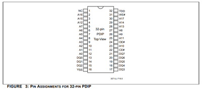

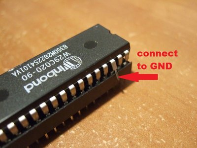

Reply 8 of 29, by Roman555
parhelia512 wrote:
The command you give is the good one, i'm able to create a 256Kb file with the same two 128Kb BIOS.
Ok. The pin 30 of EEPROM is A17 for 2MBit-chip and NC for 1Mbit-chip.
So check pin 30 of EEPROM dip32 socket (extract chip from there carefully before)
If it is connected to GND - BIOS should work. Otherwise isolate a pin 30 of BIOS chip from the socket pin and connect the pin 30 of BIOS chip to GND.
(I don't know how to say it in English clearly - Just bend out pin 30 of BIOS chip to lose contact with socket pin 30)
Now A17 will be in low level.
Make it only on your own risk.
    53.11 KiB
    400 views

Reply 13 of 29, by Roman555
parhelia512 wrote:
Thanks Roman555
If i understand correctly, if i isolate the pin 30 on the BIOS chip, it will act as a 1MB one ?
No, the pin 30 of the eeprom has to be isolated from the socket and connected to GND. Of course, it has to be programmed before with that doubled bios image. But working part of image will be low addressed one.
If you have proper 2Mbit bios image for your mainboard you shouldn't do that.
P.S. if P6F91 could be supplied with both 1Mbit and 2Mbit EEPROM it means there is a factory jumper to configure that. So pay attention to pads designated JP1 near eeprom socket - it might be answer. I think it's easy to understand which model of eeprom the motherboard has to use. If A17 of eeprom socket is connected to A17 of address bus - it should be 2Mbit EEPROM. The A17 of address bus is pin A14 of ISA slot.
P.P.S parhelia512, did I get it right that you program eeproms using a hotswap method ? Do you flash BIOSes including BootBlock ? (I mean, sometimes tools program only main part of BIOS)

Reply 16 of 29, by Roman555
parhelia512 wrote:
Do you think that changing this jumper position (can i short the pads ?) can make the board runs with a 2MB EEPROM or is there another difference on the board physical configuration that explain the 1MB or 2MB EEPROM choice ?
I've thought a little bit. Factory jumper isn't necessary for that. The pads JP1 might be just "bootblock protection" for Intel flash 28F001 - its pin 30 is for that. So just try to understand whether the A17 of eeprom socket is connected or not to A17 of address bus. If it is yes then 2mbit eeprom should work just out of the box.
Warlord wrote:
I actually don't think there is a problem with your board, I think you flashed the wrong bio for it and now it will not accept a differnt one. A better approach would be to remove the bios from the board and use an eeprom flasher until you figured out the right bios. 🤣 I think all of these fixes are based on the board being faulty which I am not convinced of, all of the evidence leads to a software and programming failure.
Yes, I agree, It might be too.
parhelia512, although you didn't answer how you program the eeprom, what software utils you use.
