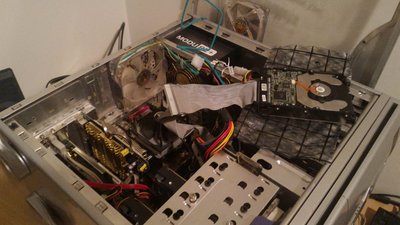

I think this hard drive had not left the case, since it was first installed 17 years ago, until yesterday:
265.75 KiB
293 views
Attached to the P4 system for the file transfer:
