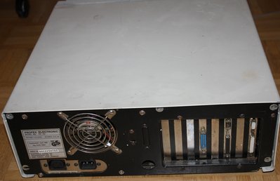

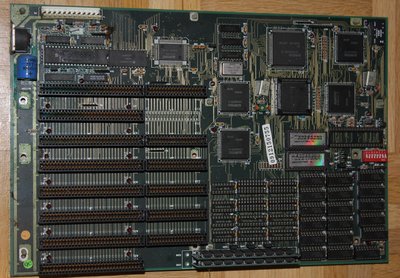

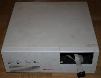

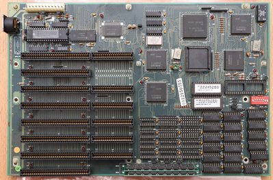

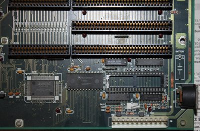

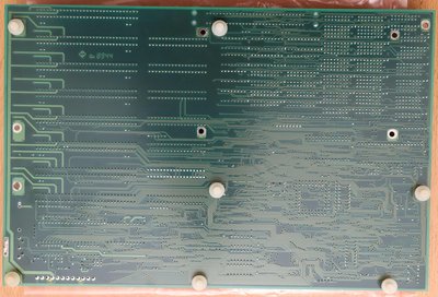

My Profex "PC 33" - Suntac 80286-12 arrived. No time at all but I had to do the emergency battery repair. Therefore some photos of what I got and whats inside 😉

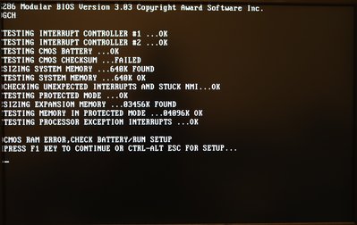

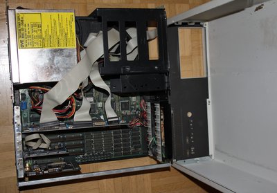

Reply 4 of 12, by Predator99

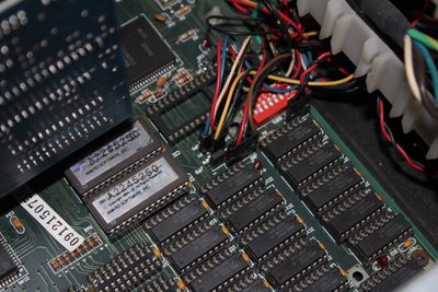

Thanks! Board is assembled again. Tested and running, including keyboard 😀 Detects 4 MB of RAM, but one bank still free?
Still need to clean the case in shower/dishwasher, but this can wait.
Will then fill the gaps: 5,25" and 3,5" floppy and MFM/RLL hard drive. Quite sure it will look beautiful again. I dont have to care too much about it, there are lots of scratches anyway 😀

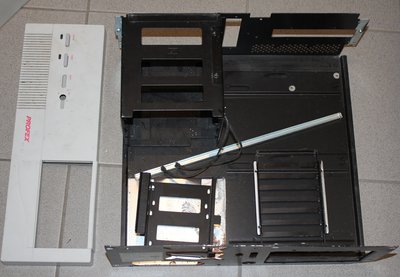

Reply 6 of 12, by Predator99

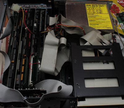

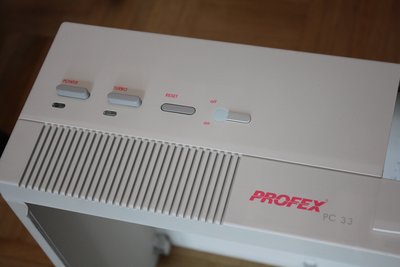

Disassembled everything and cleaned in the dishwasher:
1.73 MiB
1224 views
Front looks like new now:
1.61 MiB
1224 views
Some dfficulties with the missing mounting rails:
5.25" mounting rails - where to get?
1.69 MiB
1224 views
I will fix the 5.25" drive with the 2 rails I have in the middle. On the top I will put the 3.5" drive, not possible to fix it in the correct position without rails, but it will stay in its position without screws...
On the bottom I will mount the ST-225. I will order some longer screws for that to fix it in the case. This drive will be hidden under the cover anyway, therefore its exact position does not matter...

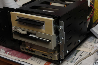

Reply 8 of 12, by Predator99

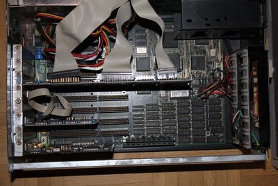

Finally the longer 6 - 32 UNC screws arrived. Now I was able to mount the 5.25" HD without rails. I had to choose a ST-238R because the Controller was RLL not MFM. Also mounted the 5.25" and the 3.5" Floppies. Found a way to fix the 3.5 in the top slot (more or less..).
1.71 MiB
1113 views

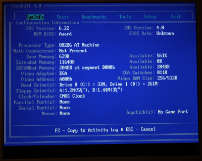

Now it was time to upgrade the System to 12MB XMS and 2 MB EMS. Also added a CF connected to a Soundblaster as Drive D for data exchange. More details about my upgrade later 😉

So inside I kept the most components I received (Mainboard/IO-card/RLL-Controller).
The RLL/Floppy Controller seems to have a loose contact, maybe I am going to replace it. But I like the unusual Blue PCB.

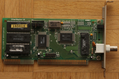

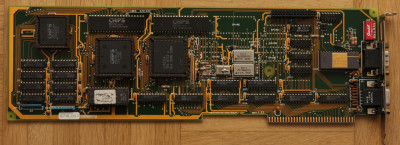

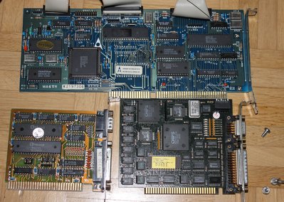

I replaced the original EGA-card with a HEATH P/N 150-307 to have the option to connect a VGA - dont have space to have an EGA monitor on my desk all the time. Switching between TTL and Analog ist done by simply setting DIP 6:
Re: Heath 150-307-3 Chips EGA/VGA
1.68 MiB
1092 views

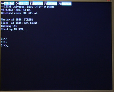

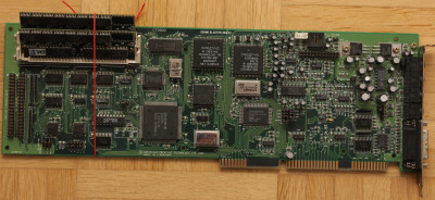

I added a CT3900 with 2x16 MB RAM. It is non-PNP therefore I can use its IDE-port to connect a CF-card on a slot-bracket and optionally boot from it. I configured the IDE as quarternary on port 168h and drive it with an XT-IDE ROM on a non-PNP Ethernet card (N200E2). The PC starts from the RLL-Disk as C: and I can use the CF-card as drive D:

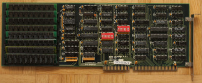

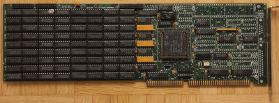

Regarding RAM I have 4 MB onboard and added RAM-card with additional 8 MB configured as XMS to get a total of 12 MB 😀
1.69 MiB
1092 views
1.72 MiB
1092 views

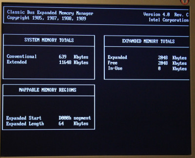

To have EMS I added a Intel AboveBoard with 2 MB, page frame at D000h.
1.68 MiB
1092 views
1.71 MiB
1092 views

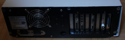

View from behind:
1.65 MiB
1092 views

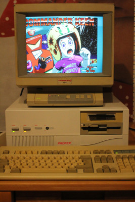

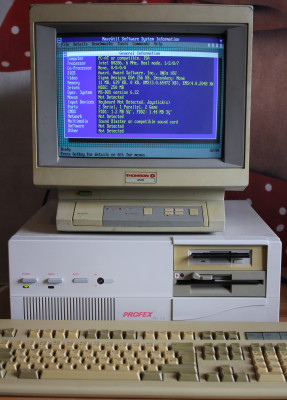

Complete with EGA-Monitor:
1.72 MiB
1092 views

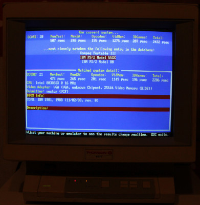

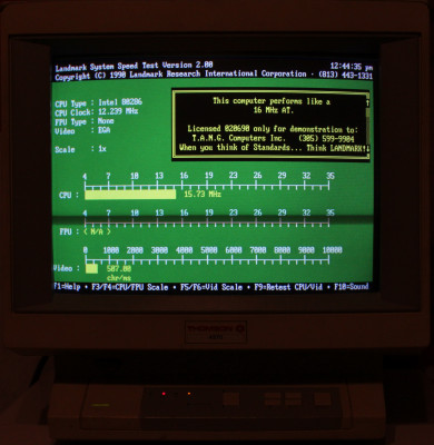

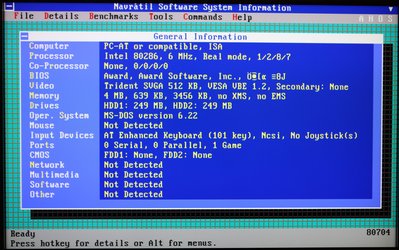

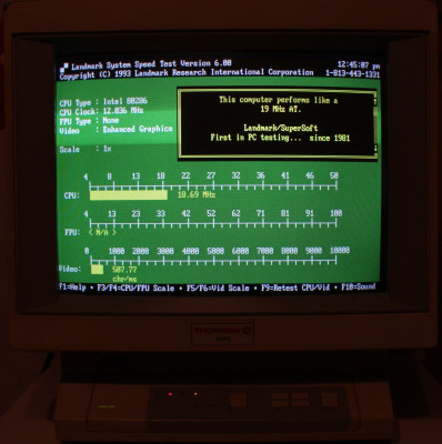

Benchmarks:
Topbench detects a 386SX but in fact its a 286-12...
1.74 MiB
1030 views
1.69 MiB
1030 views
1.72 MiB
1030 views
1.66 MiB
1030 views
