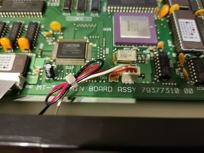

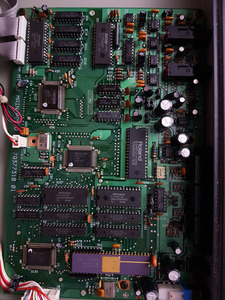

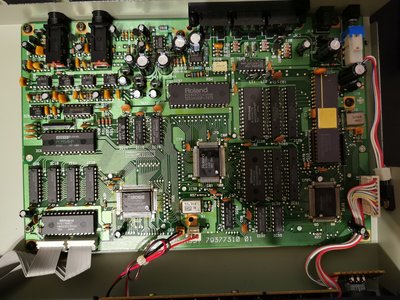

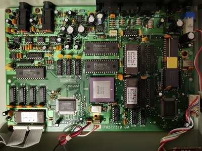

So I own two MT-32 now... both are of the "old" variety... the one I bought recently I wanted to sell with some profit but _of_course_ it can't be that easy, beacause I discovered it has different motherboard than the one I had for few years now...
Old one is SN #871290 it has motherboard is 79377310 01
the one I bought last week is SN #849553 motherboard is 79377310 00
Obvious difference is the main chip.
Also the lower SN one has socketed EPROMs (fw v.1.07, right?) while the higher SN one has them soldered on the PCB (how to check fw version?).
Which one is better?

Reply 4 of 24, by BloodyCactus
well if you have 00 + 01 the difference is really obvious if you looked at the pcb. but neither is 'better', they both have quirks. take your pick.
00 is ceramic pga. roms as eeproms
01 is plastic qfp. roms are mask roms.
Yes the physical differences are obvious. By 'better' I meant which one produces higher quality audio or has less noise on the line outs? Was the 01 revision made to fix problems with the 00 revision? (ie. rev 01 is better) Or was the 01 revision a cost reduced version? (ie. rev 00 is better)
Reply 6 of 24, by BloodyCactus
no, the 01 was made to reduce the cermiac PGA roland chip to a QFP chip.
