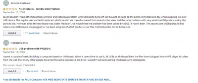

While review sites (that only see brand new parts) loved the Asus P4P and P4C boards in repair channels they were notorious for blown chipset based USB ports.
Asus costed down too far on SMD parts that protect the ports from voltage spike damage when you plug/unplug USB devices.
During DDR & DDR2 Asus costed down a lot of things too far which is where the repair channel term ASDS (Asus Sudden Death Syndrome) came from.

Reply 10 of 15, by The Serpent Rider
The problem is common for many ICH5 based boards, not just ASUS.
Reply 11 of 15, by PCBONEZ
The Serpent Rider wrote on 2019-12-30, 18:05:
Agreed but Asus was the worst of them.
Intel ultimately revised the platform design guide changing those components from 'recommended' to mandatory because of the problem.
I don't know for a fact but I don't think Asus updated their designs after that revision came out whereas most others did.
Personally I would stay away from Asus if you plan to use USB without an add-in card.
If you are going for a board with ICH5 and will be using OB USB look for the latest board revision you can find.
