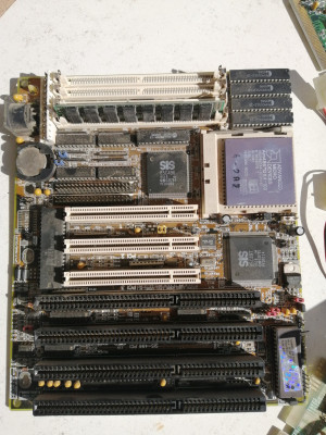

I picked this up at the flea market today
SIS 496-PCI motherboard
DX4-100
4Mb RAM
Cirrus GD5436 PCI Graphics Card

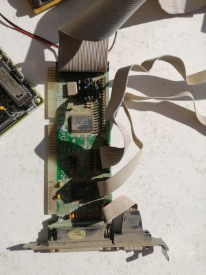

ISA multi IO card

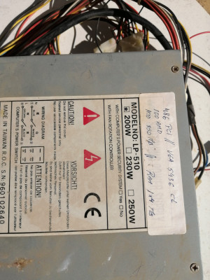

There is a label stuck to the power supply which has the spec written on it, and that matches what I have (which is also why I am sure it is a single 4Mb simm that is fitted) so I can be sure this all came from the same PC. Looks like I am am just missing the HDD.

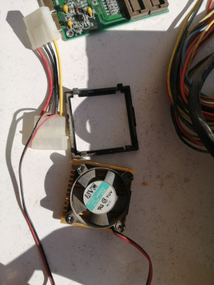

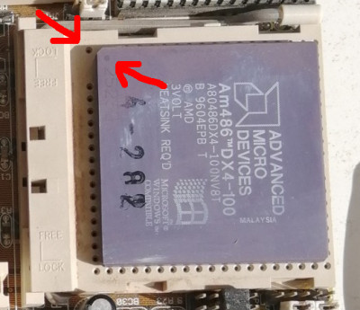

I removed the CPU fan and heatsink, and it does have a AMD 486DX4-100 CPU fitted (which is what the label said)
However I notice now that the CPU will fit in the socket any way round. It is so long since I was building 486 computers I had forgotten they do that. I have inserted it the way I think it should go back in. See pics. Is that right?
The dot on the CPU matches with the hole separated from other holes, so that's right:

The AT PSU (I used an old IDE HDD as a load instead of the motherboard seeing as I didn't know it's condition) powers up but makes a hissing noise and generates low voltages (about 0.7V on 5V and 1.8V on 12V)
I cleaned all the dust out, the fan has seized but all the electrolytic capacitors look good to the eye. That's not to say that they are, I'll have to desolder them and check on my ESR meter and capacitance meter. I'll probably just change them. It could be an optocoupler/feedback type fault also but due to the age I suspect capacitors.

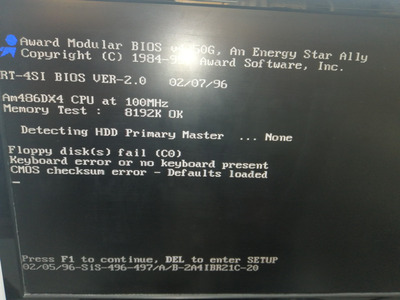

Using a known good AT PSU (from my working 486DLC rig) The motherboard makes a continuous beep-beep-beep-beep immediately on power up. There is only one EDO sim fitted. it makes no difference which slot I put it in or if I remove it altogether I get the beep-beep-beep just the same. I have +12V, -12V, +5V, -5V present plus an orange lead from the AT PSU with 4.7V on it. Googling says EDO RAM runs on 5V and I can't see a VRM anywhere so I guess I can't have a Vram fault on this motherboard. There is a TIP127 PNP transistor near to the SIS 85C497 chip which appears to be generating 3.4V on the collector so I guess that is acting as a series regulator. Anyway whatever it is for, 3.4V looks good to me.
Possilbly I have a duff EDO RAM but I don't have any more here to test with. I have 4 known good ones back in the UK and I can get my wife to pick them up for me when she goes over for a few days at the end of Jan.
According to my POST diagnostic card I have code C6 which the manual says is 'External Cache Size Detection'.
So is it possible I actually have faulty cache and not the EDO RAM? There are some jumpers on the motherboard but I couldn't find the right manual for this motherboard when I googled it. Does anyone have the manual for this motherboard (SIS-496 PCI rev 1.0) or know if the external cache can be disabled using any of the jumpers, to eliminate that possibility?
Other than possibly eliminating the cache I guess I will have to put this on one side until the end of the month and try some known good simms. I can take a look at the PSU in the meantime

There are no identifying marking on the SIMM. The chips are Panasonic MN414400BSJ-7. I looked up the datasheet for that chip and it is Fast Page RAM
I tried the SIMM in all four sockets (which the SIS496/497 chipset datasheet says it supports. No difference. I tried putting a little pressure on the SIMM when it is in the socket. No difference.
I can occasionally get the board not to beep when the SIMM is fitted but it still stops on the same POST code C6 even if it does not beep.
I guess the next thing now is I need to buy some known good FPM to see if I simply have a faulty SIMM here. Unless anyone can think of anything other to try first.

On the plus side I fixed the AT PSU. It was capacitors as I guessed. It runs sweet now and no longer hisses like a snake. It just needs a fan but that's OK I have some good spare used ones lying around.

I bought two Mb sticks of FPM RAM from ebay £8.83 inc postage. These ones
https://www.ebay.co.uk/itm/Pair-of-Smart-sm53 … 872.m2749.l2649
I inserted those and it boots. as the simm that came with the board was also 4Mb FPM I can only assume it was faulty.

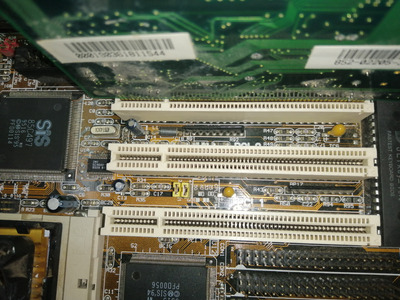

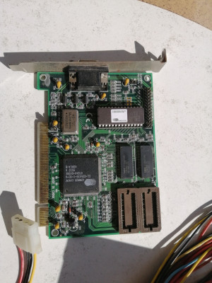

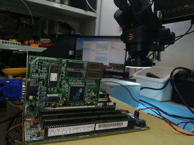

However I have another problem with it now. If I put the Cirrus SVGA card in the PCI slot nearest the ISA slots it will boot up to POST screen
If I put the SVGA card in either of the other PCI slots it bleeps......... beee-bip-bip-bip which Ithink is saying no graphics card present. All the PCI slots look clean. is this a fault or a 'feature' of these old motherboards?
