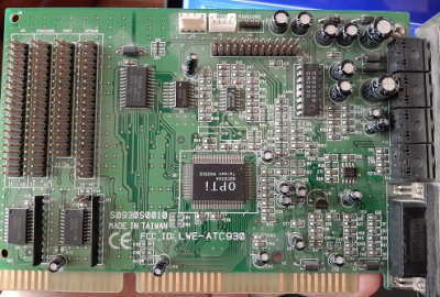

Reply 5 of 10, by mac512
I forgot to mention that I would like to add a sound card.
I have a generic Taiwanese card that sports an OPTi chipset (82C930A). Do you think it would work in the 5162? How about the IDE connector on this card? I know those connectors are usually intended for connecting CD drives but, as it has dedicated connectors for Sony, Panasonic and Mitsumi, I thought that the fourth connector may be usable with IDE HDs...

    Generic OPTi sound card
