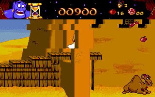

I was wondering why is there annoying screen tearing present in some games...At first I thought this might be if DOSBox refresh rate is not synchronized with the display rate, but now I managed to grab a screenshot which should not be refresh rate dependant. Is this a bug or a flaw in the emulation? I do not recall having any screen tearing in dos games...

Since the screenshot is made from dosbox internal buffer in render.cpp this should be well before any output settings. But I did try the fulldouble option (with surface output) and no change. I might add that I notice tearing in other games as well although it's less apparent if the screen is not scrolling horizontally.

I followed your advice and set VGA_PARTS to 1. While there was still tearing in the games, the picture was only broken once in some frames. A typical issue when vsync is not used...
Then I dusted off some old computer I have lying around here and loaded the test games native in DOS 6.22. It seems that most games indeed do not use vsync as I noticed the same problems. I wonder if my vision is getting better through the years 😁. I could swear I never noticed this few years back.
Anyway, VGA_PARTS seems to help to some degree because it does not make weird artifacts when frame is split 3 or 4 times between frames. I didn't notice any slowdown so I guess I'll be compiling it like this.

it was there as the amount of time spend in the screenupdates (if it's in one part) caused sound stuttering now and then.
