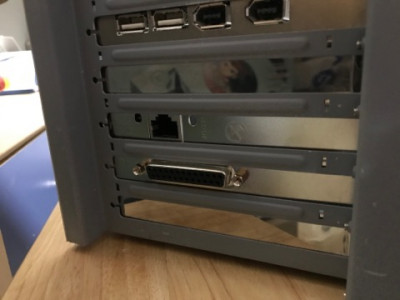

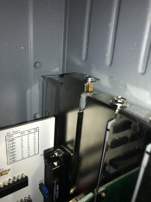

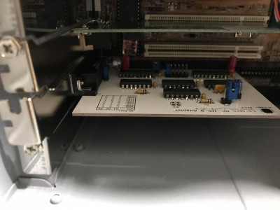

So i bought an IMB parallel port card which was non working and took the ISA bracket and fit it to the Lo-tech card. Installed it in my PC but have now noticed that the ISA bracket seams to be to long in that it is not flush with the case and cannot be screwed in. (see pics)
The ISA bracket is normal length as far as i know so I can't see any reason why its like this.

The bracket came from an ISA card not a PCI card,
As per the Wiki it says "A standard DB25 port provides compatibility with the original Roland cables, and is positioned such that the ISA slot bracket from an IBM parallel port card can be used"
As you can see from the Pictures provided the card is properly installed in the ISA slot and the bracket which came from the listed IBM parallel port card also fits the card...it for some reason is to long which it shoudn't be.

The other option is to use a motherboard standoff and screw it into the case where the bracket is supposed to screw down and then tighten the bracket down onto that. I have a video capture card that I did that with and it works fine.

The gap is perfectly the size of a motherboard standoff (when screwed into the case) I had to hold it with plliers when securing the screw for the card but now it doesn't move or anything.

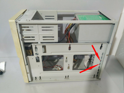

Glad that you found a way to secure the card. Just to rule out the obvious, are you sure that the tip of the bracket is going through the holes pictured below? Sometimes the holes are too small/thin or the bracket is slightly misaligned with them and this is exactly what happens. I doubt this is the case of course since the card appears to be correctly seated, but just in case...
