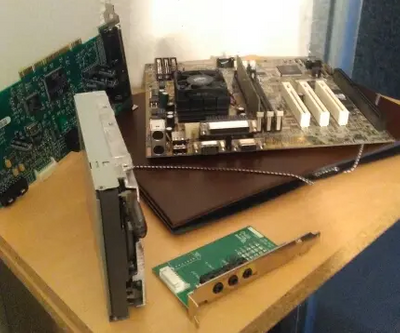

It's a priceless ad and the seller doesn't know what he is selling. He won't send me any photo unless I tell him before how much I'm willing to pay. I've failed to identify both boards. It's a strange motherboard, ATX and SDRAM only but without AGP slot. S7 or SS7? The other one looks like a PCI sound card with the input and output connectors in the small card.

Looks like a socket A mainboard to me. At least judging from the cooler. It has VGA on-board, hence no AGP.
Socket A with black ATX panel? Never.
From the looks of it, it's a SIS based Socket 7 board. Most likely SIS530, because there's a bulky southbridge.
EDIT: That's ASUS P5-99VM.
EDIT2: The PCI card is one of the Conexant sound card + modem combo models. Something like this one (identical chip).
Reply 3 of 8, by Bellator
The Serpent Rider wrote on 2020-01-19, 19:42:
Socket A with black ATX panel? Never. […]
You found it. Thank you very much.

Reply 5 of 8, by derSammler
What ATX panel? Are we looking at the same picture? I don't see an ATX panel there.
Close, but doesn't match. The section in front of the PCI slots is different.

Reply 7 of 8, by Cobra42898
i have a hp pavilion s370 board that came with one of those modem/sound daughter board setups. perhaps this came from one of those? this is not something id expect to see in a typical tower. the short mid towers used this because they were so cramped.
Searching for Epson Actiontower 3000 486 PC.
Reply 8 of 8, by Bellator
Cobra42898 wrote on 2020-01-19, 22:40:
Yes, all this seems to come from a HP Pavilion 6640C. Asus OEM P5S-VM board (the same as the P5-99VM) with a K6-2 500 MHz and 64 MB SDRAM.
