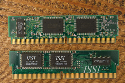

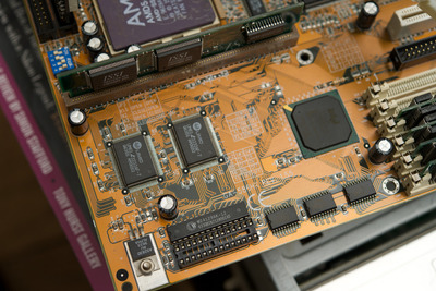

Trying to upgrade my Triton II based motherboard (GA-586HX 1.55) to get cacheable RAM > 64M.
In stock config there is 256kB L2 cache and one 16kx8 SRAM TAG chip onboard + one empty 28pin socket.

Both of my COAST modules are 256kB and they have their own TAG SRAMs:
550.72 KiB
384 views

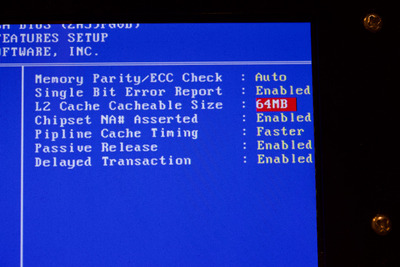

So when I put one of these in the COAST slot, I'll get 512kB L2, however the cacheable range is still only 64M.
There is a BIOS setting that flips between 64M and 512M. However, the board doesn't POST when I set this to 512M no matter if with COAST module or not. I was hoping the chipset would use the extra tag on the COAST to get the extra cacheable range, but it doesn't seem to be the case.

So I am wondering I need to put something to the free SRAM socket. Unfortunately, I don't have a 16kx8 12ns chip, but I have abunch of 32kx8 15ns which should be compatible AFAIK. However, when I put this one in the board doesn't even start.
Any idea how to get this working? Do I need some sort of special tag chip?

Reply 1 of 7, by The Serpent Rider
According to the manual, you need to install additional SRAM to cache 512Mb. And yeah, 16kx8 chips only (15ns or better).

Reply 3 of 7, by The Serpent Rider
I think additional TAG must match size of the one which is soldered on board. 256Kb COAST modules TAG usually won't match.

actually, 32kx8 should in fact work. if you google for GA-586HX images, you may see several boards that have such chips plugged into the second tag socket.
now as to why your board doesn't boot with that chip inserted, even with the COAST off, did you make sure your SRAMs are working good? if it's the relabled parts with brown writing and iffy date codes, you may need to test a couple of them until one actually works. regarding the tag on the COAST, i would assume it's just not designed to use that, given that there already is a 16kx8 chip on the board. the ISSI SRAM on your COAST is just 8kx8.

Reply 5 of 7, by mpe
Yes. The 32kx8 chip should be working as it was a pull from one of my 486 boards where it is working fine.
Since there are no jumpers I wonder if the chipset scans the tag bits at reset trying to identify the size and it fails due to using non-matching chips.

Reply 6 of 7, by The Serpent Rider
Revision probably matters. Or maybe it's early BIOS version bug.
Reply 7 of 7, by RacoonRider
A long time ago I played around with Asus P55T2P4, a 430HX board. It already had maxed out cache (no COAST slot) and I know for sure that both 16k8 and 32k8 SRAM chips worked. I tried a few 12ns and 15ns chips and they all worked.
