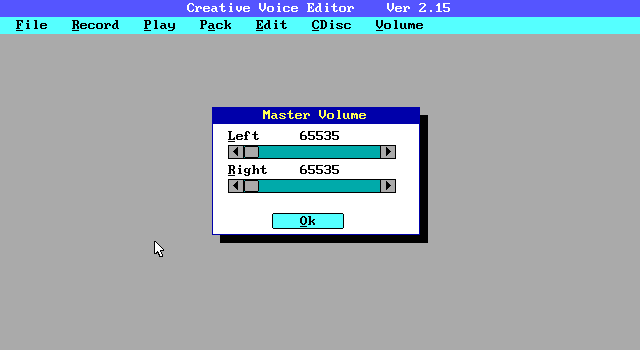

Thus "out of the box" CTVED and VPLAY won't work and will need a small hack to run.
The drivers "CTVDSK.DRV" and "CT-VOICE.DRV" have a version # of 2.12 while CTVED shows a version # of 2.15, a quite simple fix.
At address 0x30 to 0x32 you find "h 2002" for the default blaster address and "h 07" for the interrupt (while CT claims 5 is default), right behind follows the version # "h 0c 02" which is 2.12 "h 0f 02" will reflect 2.15, if you change this in both drivers and hacked in also your actual interrupt you specified, CTVED and VPLAY will work.
I strongly assume this is only DOSBox related or on any virtual DOS machine as long as windows isn't present because the installation routine will quit and the drivers won't be updated to your systems specifications as well they will have a wrong version #.
Still it seems to be unstable, at least i got it running fine last night right today at noon they failed again - i forgot that they depend on sbpro2.
(probably this can be hacked to type 6 "sb16" to, i don't know yet).
But it still can report "wrong card", don't be surprised if it fails.
However VPLAY is the best voc player i found so far, it plays well, doesn't have this annoying click when it starts as most other, properly silences the noise for silent blocks, it's stereo capable and the stereo channels are assigned proper l/r (most voc players mirror the l & r channel never ask me why, it only gets obvious if you play a "left channel - right channel" file, this is the case for almost all players derived from the miles sound drivers).
If it runs and you still won't hear anything - the master and voice volume is at 0 if you start CTVED.
