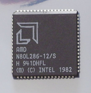

The CPU in this board is unusual since it doesn't appear to have a speed marking.
Reply 4 of 18, by Cyrix200+
The crystal would suggest a 12MHz part, but still odd it isn't marked. QT-129 seems to be a type indicator, but Google doesn't recognise it. The QA sticker might be a brand? LIN? UIN?

Reply 10 of 18, by maxtherabbit
Anonymous Coward wrote on 2020-01-28, 09:00:
it used to - if you look close you can see the remnants of a -8
Reply 11 of 18, by Cyrix200+
maxtherabbit wrote on 2020-01-28, 15:12:
With a 24MHz crystal, would that be divided by 3 then?
I think it's the remnants of 12-S.

Reply 12 of 18, by maxtherabbit
Cyrix200+ wrote on 2020-01-28, 15:21:
With a 24MHz crystal, would that be divided by 3 then? […]
yeah good call
Reply 13 of 18, by Anonymous Coward
Being a Chinese motherboard, perhaps the CPU was being overclocked and the speed rating was sanded off to obscure that fact.

Reply 14 of 18, by maxtherabbit
Anonymous Coward wrote on 2020-01-28, 16:49:
I think you nailed it I bet it said - 10/S before
