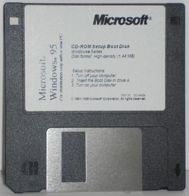

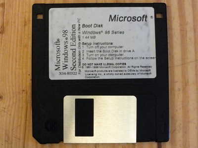

No need to install DOS first if the system can't boot directly to CD.
Win9x came with an install floppy boot disk. You boot to the floppy and then run setup from the CD.
https://www.retrocomputing.co.uk/p/windows-98 … stallation.html
The attachment Windows 95.jpg is no longer available
The attachment Windows 98.JPG is no longer available
