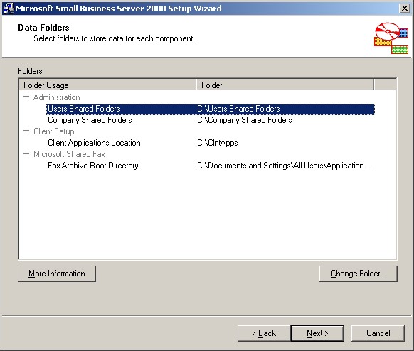

The Wizard also sets up some default shares
2003 did the same and it was always left as default on c:\ which caused problems few years down the track. remember this was back in the day of physical servers and no easy way of extending partitions not to mention the boot partition which would slowly fill up with updates, upgrades, etc. c:\ was the worst place for most of this! Although to be fair on techies of old it's a pretty non descriptive screen.

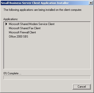

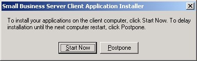

Windows will want to reboot as normal. What's not normal is what happens when you log on as the user we setup before
Even though the server is SP4 the SBS Install CD's were only at SP3 so this is what was included during the setup wizard, no doubt it's possible to update this somehow but this was one of those features which would have been really useful but never saw used in the real world, We'll do the same and manually apply SP4
After SP3 is applied next reboot comes up with another screen related to our SBS install
It's quite nice that it gives the option to postphone, Unlike more recently where even Sever OS's would auto reboot by default after applying updates ! WTF Microsoft?
Hitting Start now and those programs we setup earlier are setup for us automatically (accept my lazy Office package that starts the normal setup wizard)
