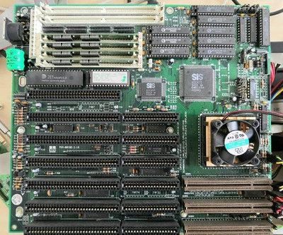

HI all,
I am looking for an exact version identification and most importantly manual for mobo in the picture

Detailed pictures are here

It is a DTK PKM-0038S and appears to be a Ver 3 (definitely not a V6) but hard to tell if the jumpers are exactly the same from the poor picture.
Can you take a better picture of the whole board ?
The jumper settings to a V3 are here: https://stason.org/TULARC/pc/motherboards/D/D … 038S-VER-3.html

My mistake, full array of pictures in the link is now available,
I already got as far as stason.org, please notice that the RAM banks do not match (there are 4x30pin and 2x72pin), so this is not a correct manual

The rev1 of the same board has only 8 bit simm slots : https://stason.org/TULARC/pc/motherboards/D/D … S-VER-1-00.html
So you must have a rev2 board or something like that, which has no documentation it seems ... Or perhaps the scheme on th99 is wrong (this is also possible).
Yes in TH99 one of the Asus boards has the wrong picture so possible that the Rev 1 board pic is wrong. In the real pictures it shows E-1A which could be Rev 1.A.
