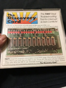

Reply 4 of 6, by Horun
I respectfully disagree. If you have a LPT port or Com port that the motherboard or addon card physically assigns an IRQ then it will use that resource even if Windows says it does not. I have this special diag card that has proven this to me many times because it checks at the true hardware level and not thru software.
