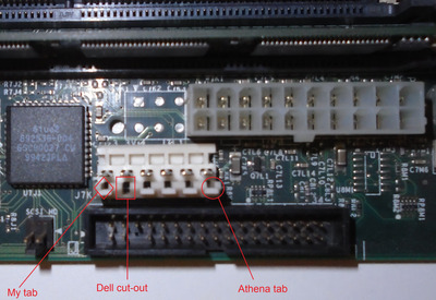

When you say the 6-pin adapter won't fit; have you tried it. These headers are almost never keyed now in such a way that only a specific plug fits a specific header - if you look at the back of each header pin you'll see a channel behind each one, so it doesn't matter where the tab is on the plug if you present it at a slight angle when fitting it'll slide right in. It's the wiring that matters rather than the plug, and the Athena one will do the job just fine.
It physically won't fit unless I cut that tab off. There's only 1 slot for that tab to fit into the connection on the MB, and it's in the wrong spot on the Athena adapter's plug. You can actually see what I mean on the first pic from that post you linked to - only 1 cut-out for that tab.

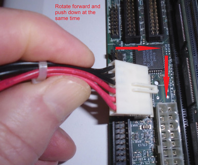

Dochartaigh wrote on 2020-02-23, 17:41:
Yeah, and I have the exact same 6-pin header on my Dell motherboard with the same cut-out position, but the adapter I made still fits - that's why I mentioned the technique of angling the plug into place.

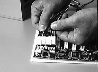

All you do is present the plug to the header at an angle so that the tab hooks underneath the piece of plastic which normally blocks it, then you rotate forward and push down at the same time and the plug will slide right on
1.09 MiB
641 views
and the same technique, but with the standard P8/P9 connectors
282.75 KiB
641 views
