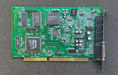

My 486dx4-100 computer build is suffering from audio Static
I have a Sound Blaster Pro 2.0 installed right now.
I already swapped it out for another one but it is plagued by the same symptoms.
I checked all the jumpers and setting and cables and drivers.
It is fine.
The problem is in some DOS games I hear allot of static.
I have another IBM 486dx2-66 computer build that has a AWE64 sound card.
It plays audio great. and games play great. No static. and the sound is crisp and clear.
I am concidering putting one an AWE64 into my 486dx4 computer.
But that would NOT make it period correct 1993.
What should I do ?
Try to find a better driver for the SB Pro 2.0 or just replace it with the AWE64 ?
The AWE64 is dated 1997
The SB Pro 2.0 is dated 1992

Sounds to me like the card either needs to have new capacitors installed and/or you are getting a lot of ISA bus noise.
Either can be easily fixed.
Pics of your motherboard?

The CT1600 is pretty sensitive to bus & environment noise, so upgrading to the far less sensitive CT4500 would reduce noise. To stay 1993 period-correct you could look for less noisy cards. GUS and PAS16 immediately come to mind. GUS is prohibitively expensive, PAS16 far less so.

It’s NOT the CT1600 that are bad. I think it is a driver issue or just game compatibility.
The CT1600 sounds good with the DOS players provided with Creative install package.
.Wav and MIDI files play crisp and clear.
It’s just some games that Static is heard.
But the CT4500 seems to have better game compatibility and I don’t hear any static ever.

The CT1600 uses no drivers in DOS.
CT4500 having better game compatibility? Huh? What are you smoking?
It is a Sound Blaster Pro 2.0. It should work with every game out there that supports a Sound Blaster card in DOS.
And the CT4500 doesn't have real OPL3.
My pretty well educated guess is that the CT4500 has better ISA bus noise filtering as well as cleaner output overall.
If your motherboard doesn't have electrolytic capacitors on it, then it will be a very noisy board regarding the ISA bus. This leads to noisy sound cards that don't have good bus filtering built in.
Could also be a sucky power supply giving dirty power which the CT4500 is probably better about as well.
Another thing it could be is that the volume POT is dirty or the output plug has a poor connection. Yes, it could be the same on both cards. Just because you swapped out a card doesn't mean that they both don;t have the same problem.
Have you tried then in another system that the CT4500 works well in?
What speakers are you using with the SB Pro 2.0? Have you tested those speakers with the CT4500?
Still no pics of your motherboard (NOT STOCK PHOTOS).

You probably have a lot of noise on the ISA bus, your motherboard may have poor filtering in the first place or aging capacitors. Regardless, unless you recap it completely to check, or buy a server grade quality 486 board, you are served best by installing a card less susceptible to noise on the ISA bus. That often means installing non-period correct hardware from a few years down the line as there were no SB Pro compatible quality alternatives at the time. The GUS and PAS suck ass for games, despite being good cards overall. Either use the AWE64 and use its SB16 compatibility and wavetable synthesis, or buy a high quality SB Pro soundcard without wavetable (as these are often not in high demand) such as the Terratec Gold, Turtle Beach MonteCarlo, Aztech Pro16, AOpen S23, etc.
