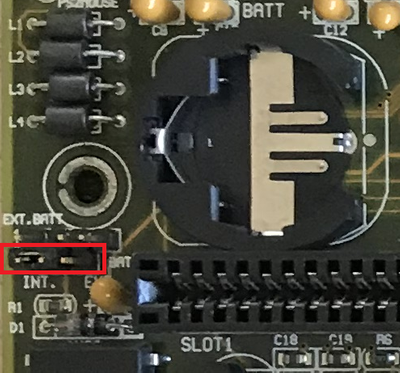

Reply 1 of 6, by TheMobRules
Make sure the jumper just above the keyboard controller chip is set to INT. as that one switches between the on-board internal coin cell battery and the EXT. BATT. connector.

Reply 2 of 6, by AlexZX2
I have checked the jumper it is set right 1-2. The BIOS saves everything i set. And it also remembers the time but the time is not running when the computer is off. When i turn it off wait for a while and turn it on again. The time has still the value from the moment when the computer was turned off. Very strange.

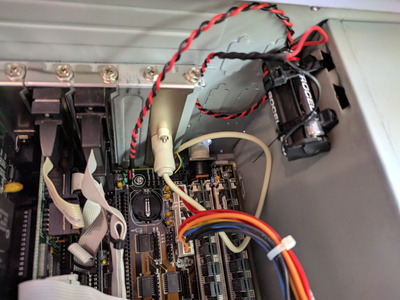

Reply 4 of 6, by AlexZX2
Hi everyone, i tried the external 4.5V battery block of 3 AAA. And now it's working, the time keeps running when the PC is off. But strange that the onboard battery is not working.
Does anyone have an experience of how long the 3 AAA batteries last or how often you have to change them?
Reply 5 of 6, by Horun
Great ! Those AA should last a few years, longer if you use the computer often. The cmos draws so little that basically the batteries will last about as long as their typical shelf life of about 5 years +/-

Reply 6 of 6, by TheMobRules
If the external battery is working then the problem is somewhere in the path between the coin cell and the 85C407 chip. In addition to cleaning the battery holder contacts as Horun suggests, if you have a multimeter you can trace the route from the internal battery to the chip, look for broken connections, or blown resistors/diodes... I don't think there are any more complex components in the path.
