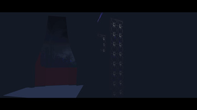

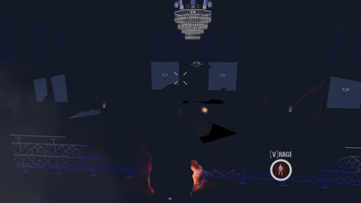

I just got this game from Amazon,and i got it installed okay.When i was playing i noticed the main character in the T-pose,so i followed the steps on the pcgamingwiki Scarface page on Corrupted graphics section:-
This involved putting the DgVoodooCpl.exe & D3D9.dll in the games directory.
https://www.pcgamingwiki.com/wiki/Scarface:_T … en_refresh_rate
My main character was not in the T-pose anymore,but i was getting weird graphics whilst playing the game(see uploaded images).Does anyone know a fix for these weird graphics i'm getting?.

Strange, it works fine here.
Could you check it plz with the MS WARP output? It'll be slow but the point with that is to check if the rendering is as expected.
My tip is, you have and AMD card, on which dgVoodoo reportedly works improperly. Solid colors instead of textures and such. 🙁

I managed to fix my problem.I did by Downloading 3D Ripper FX from here:-
http://www.deep-shadows.com/hax/3DRipperDX.htm
I then started 3D Ripper FX,and selected the Scarface.exe.Then i started Scarface from the app and it worked fine.
Yes using the MS WARP output solved the problem as well,but you're right it was slow.
