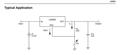

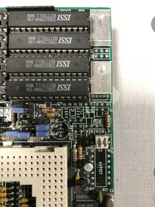

I've been playing around with my Jetway J-403 VLB GREEN mobo I bought with an oddball Cyrix DX2 CPU a year ago. Got some overkill size 2x32Meg EDO modules from china. DOS won't really use it much. I got hooked on exchanging it to a DX4. Went ahead and bought an AMD DX4. Unfortunately the mobo only supported 5V core processors, while every jumper manual I could find had a 3.3V option. Mine had fixed bridges instead and no 3.3V regulator. I couldn't find any 5V DX4s, most of them are 3.3V Vcore only.

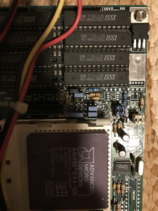

I'v read a few application notes from datasheet archives from that time and started some reverse engineering. Interposers were not an option, because of their availibility and pricing. Finding just a Socket3 connector is hard nowadays. The AMD DX4 had the same 5V I/O voltage as the DX2, so I only needed to find a regulator and two resistors to set up the output voltage that can fit in the unpopulated pads. Some jumpers and headers too. After fiddling a bit I'd found the correct one, a general LM350 and two 1/4W resistors. My major concern was overheating it when the CPU starts to sip up more power. Even dropping only 1.7V while there is 3A current flow can lead to like 5W. That's real heat right there! Of course I had to install a heatsink too to keep it cool.
The BIOS isn't recognizing it correctly even after setting the correct CPU type jumpers. This board doesn't even have the ID pin connected in the CPU socket. But hey it works and it's much faster and stable then the Cyrix one was!
It's still working flawlessly after a few months of usage!

I have added 3.3V support on all the mobos I have which are supposed to have support but regulator isn't present. I have one board which is not stable with 3.3V, I will have to try to see if boosting voltage makes it stable.

I have scoped the voltage rail and there's no problem there, it does seem chipset just isn't playing along with the lower voltage levels coming out the CPU at the speed it is needed to run at. Lower bus speed (25MHz) made things work, sometime later I'll up tho voltage rail and that should make things work at 33MHz and if I'm lucky 40MHz.
