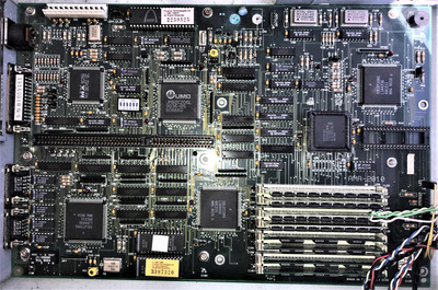

Hi,
I need help to indentify, if possible, this card from a KENITEC 286/16. Working, but leaking battery. I need help to:
- find Switch and jumper meaning

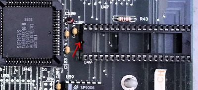

- in wich way should I insert a 80287 ? U49 in the left.

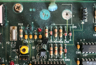

- find how I can replace the baterry with a 3V battery. On the picture below there is a connector for external battery with 4 pins, 2 are grounded (upper ones). How should I connect a battery ? Remove or change Jumper J ?

First of all, take care of the corrosion. It doesn't look very bad now, but leave it like this and it will get worse. Use vinegar and a small brush or cotton swabs, keep the board tilted so it doesn't spill towards the center. After removing the green oxidation as much as you can, rinse the area with isopropyl alcohol and let dry.
The external battery connects to pin 1 and 4 of that header, and since you've already discovered the GND pins it's clear which one will be the positive (the one that goes to the anode of CR3 😀 )
You will have to try and find the best voltage for the external battery, some boards work with 3 volts, others require 4.5 or even 6 volts. You might not need to change any jumpers for the external battery to work.
For the 80286, notice that the socket has a notch (left side in your photo). The chip should have the same notch, just align them properly and you're good to go.

Cleaned the board. Using 3 1.5V AA battery with tape and a connector, now, BIOS params stay.
The notch in the socket tells which way to install it. BTW you need a 10Mhz or faster 80287 as most boards run the 287 at 2/3 speed of the cpu unless you have jumpers to set it's clock at a different rate. I see the 32Mhz XTAL for the cpu and a 40Mhz Xtal so am guessing the 287 runs at 10Mhz (no other reason to have a 40Mhz Xtal unless the board supports a 20Mhz 286). Either way make sure you get a fast 287.

I bought a 80287 XL from china,brand new, never used. inserted in the correct way, it's working perfectly ! 2 time faster than a stock 287.
