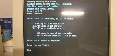

- Can I format a 360KB floppy in a 1.2MB drive? I tried and it weirdly enough said it was "formatting 1.2mb" and then said there were 200kb of bad sectors and 900kb usable (on a 360kb floppy as far as I can tell) but the floppy really didn't work well anymore at that point, especially in the 360kb drive.

EDIT: added a screenshot of the format I did, as you can see it said something about a "different file format" and that I wouldn't be able to "unformat" but then proceeded to format it labeling it a 1.2MB floppy.
You need to tell format that it's a 360KB disk. You can not format it to 1.2MB, for obvious reasons.

1.2MB and 360K are completely different only in writing heads width track. 360K is wider than 1.2MB also is narrower.
Can read 360K on 1.2MB and can write a blank 360k disk on 1.2MB pretty good but comes up a problem when 360K drive formatted on 360K disk then write on 1.2MB in 360K mode then you have more problems on reading messy 36oK disk in 360K drive due to mixed width on each tracks.
Better find a real 360K drive.
And another issue is 1.2MB write amplification is stronger than 360K meant 1.2MB disk formatted as 360K in 1.2MB drive have hard time writing data hard enough impressions on 36oK drive.
